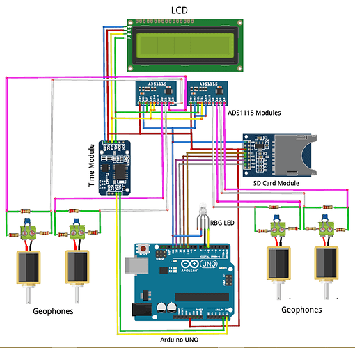

Hi, guys. I have been working on this project for a while now. The geophones are thrust into the ground with spikes attached to the bottom. If there is any vibration, the magnets are set into motion. Then, there is a change in the magnetic lines of force, which induces EMF is induced. The induced EMFs are passed into ADS1115 (a programmable amplifier) because the EMF is too small for the Arduino ADC ports to measure. So, I utilize two ADS1115 in this project, and the geophones are attached in a differential mode as seen on the circuit diagram.
What I am having a tough time with is how to use the time stamp from Arduino to know the time it takes (in milliseconds) for each geophone to record an anomaly whenever a button is pressed for the detonation of acoustic waves. Because I want to be using artificial methods of creating vibration. Below is my code for the project.
