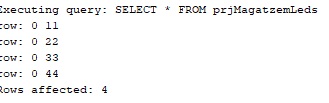

I need to read data from a table in a SQL server. I am using an Arduino Mega with a Sahild Ethernet. I can connect to the SQL and I can read the data from the table. But I don't know what I'm reading. Do not read the first column. I am actually recovering the data in a strange way.

As you can see, the first column is not read.
I also think that the system I use is not correct.
static void row_callback(void * u, const tdsl::tds_colmetadata_token & colmd,
                         const tdsl::tdsl_row & row)
  //SERIAL_PRINTLNF("row: %d %d %d %d %d", row [0].as<tdsl::int32_t>(),
  SERIAL_PRINTLNF("row: %.4s %d", row [0].as<tdsl::char_view>().data(),
                    row [1].as<tdsl::int32_t>());
Thanks for the help.
I attach the structure of the BD. I can't read the first field. In tales of reading "01;05;00;02;00;00;6C;0A;" i read "0".
But I think I have the field well declared:
I am attaching an image of the structure of the table.
SQLEstructura
If I change the table structure it works.
SQLEstructura2
Result:
xecuting query: SELECT * FROM prjMagatzemLeds
row: 01;05;00;02;00;00;6C;0A; 11
row: 01;05;00;02;FF;00;2D;FA; 22
row: 01;05;00;00;FF;00;8C;3A;! 33
row: 01;05;00;00;00;00;CD;CA;, 44
Rows affected: 4
