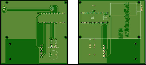

For the RFID version, there is a PCB design for production by photo path or from GERBER files. The PCB is double-sided with overlays.
GERBER file can be made for really good price at some JLCPCB or PCBWAY manufacturers. Dimensions of PCB is 100x105mm. Both versions of PCB designs are delivered free of charge to RFID DOMINATOR.
