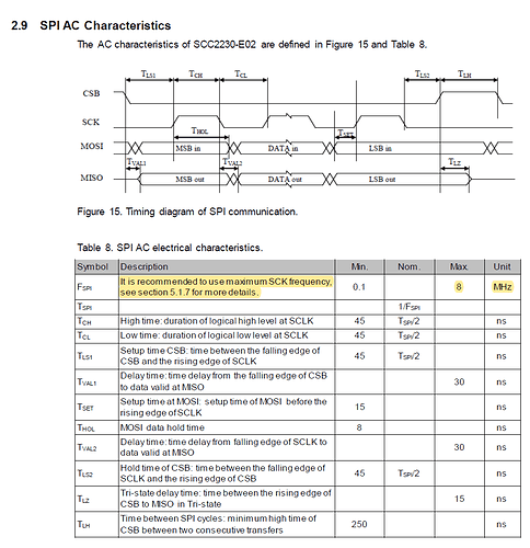

There might be some timing issues. I am running ESP32 at 40 Mhz. Now put "setClockDivider" to "SPI_CLOCK_DIV8" which makes 5 Mhz. Recommended is 8 Mhz, but I think it is still in range.
However some other tweaking is maybe necessary.
I have realized that the sensor is holding Slave Select and MISO pin high. Multimeter shows around 3.3 V. Contacted to the technical support.
