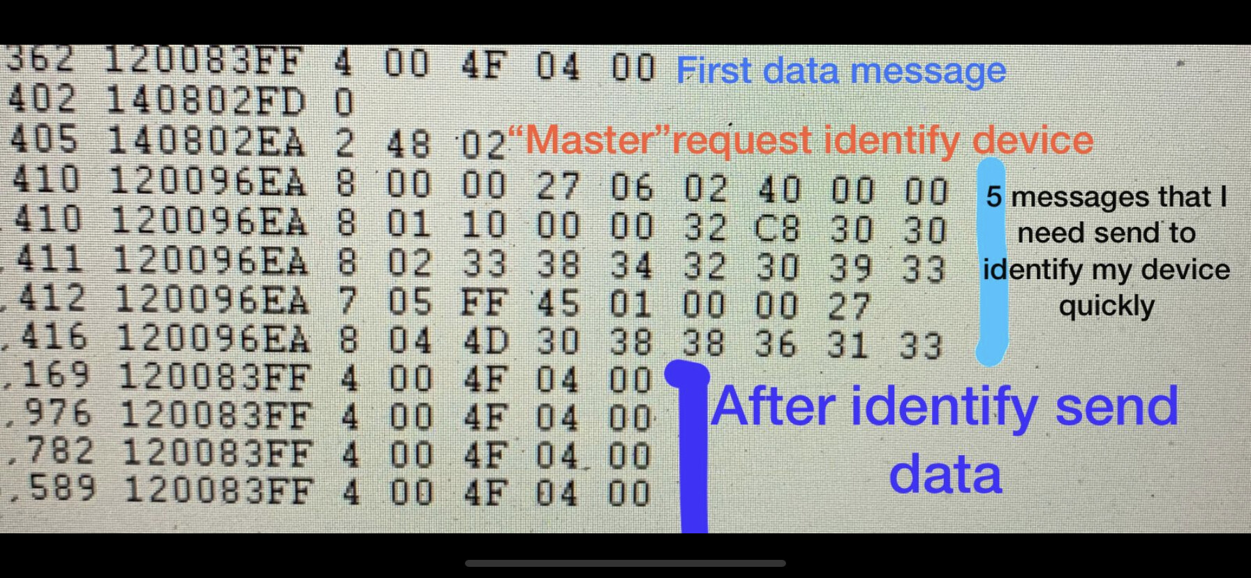

I am working at a speed of 1 mbps, in the Can network I have few messages working... I attach a photo of how my program should work: when the "master" responds 48 02, I must respond quickly to those 5 messages in the time indicated in the capture that make up a set of segmented packets which identify me and allow me to start sending the data I need, otherwise I cannot identify my device and the master will not read my packet with the data.

Why don't you use the same approach as in post#2?

Looking at the code in post #1 you are using mcp2515.sendMessage without checking the return code, therefore you are assuming that it always works, but you don't know for sure.
Anything other than a zero indicates a problem of some kind.

In your example it's something like
MCP2515::ERROR result = mcp2515.sendMessage(...
