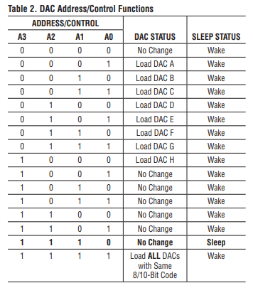

1. I would recommend just to test the functionality of only one channel (DACA) and then extend the idea for simultaneous check of all the DACs at the same time using for() loop.
2. Operate the DAC at a SCK rate less than 5 MHz as the 5 MHz (as per data sheet) spec is the design value and not a tested value. I would recommend 125 kbit/sec (125000).
3. I would recommend to use DPin-8 other than SS/-pin (DPin-10) to drive the CS/-LD pin of the DAC as the DAC requires that CS/-LD pin should be at LL during active period of SCK and LH to latch the data.
4. Look at the following diagram and form the data frame on a piece of paper before entering them in the sketch.
Figure-1: Data transfer timings
Figure-2: DAC addresses
(a) 4-bit address of DACA : 0001 (A3 A2 A1 A0)
(b) 10-bit for DACA (arbitrary value) : 0111111111 (D9 D8 D7 D6 D5 D4 D3 D2 D1 D0); Vref = 5V.
(c) 2-bit No-use : 00 (X1 X0)
5. Formation of 16-bit integrated data from Step-4a/b/c so that the bits are aligned with Fig-1
int x1 = 0x0001; //address of DACA (lower 4-bit)
x1 = x1 << 12; // x1 = 0001 0000 0000 0000 (now upper 4-bit is DACA address)
int x2 = 0x01FF;    //0000 0001 1111 1111 (lower 10-bit is DACA value (arbitrary)
x2 = x2 << 2;       //0000 0111111111 00 (DACA value is shifted left by 2-bit to take care of X1 X0)
//--We want: A3 A2 A1 A0  D9 D8 D7 D6 D5 D4 D3 D2 D1 D0 X1 X0---------
x1 = x1 | x2;        //x1 = 0001 0111111111 00 = 16-bit
6. Transfer x1 of Step-5 using SPI Bus
pinMode(8, OUTPUT);  //DPIn-8 will be connected with CS/-LD pin of the DAC instead of DPin-10(SS/).
digitalWrite(8, LOW);            //allow the SCK to be active in the DAC
SPI.transfer(highByte(x1));
SPI.transfer(lowByte(x1));
digitalWrite(8, HIGH);            //latch 16-bit data into DACA
7. Execute your program for DACA only. Connect a DVM at Pin-2 of the DAC. Check that there is some DC voltage. Change the content of x2 variable of Step-5; re-run the program; check that the reading of DVM changes.
