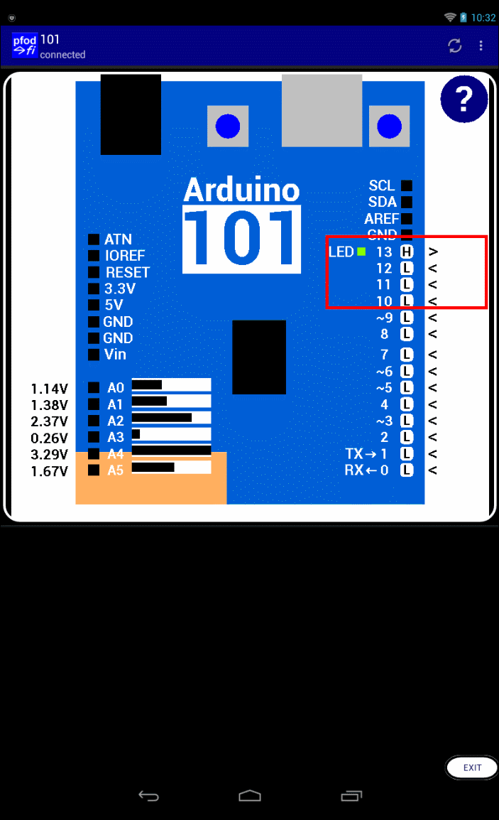

You could use my pfodApp (www.pfod.com.au) which allow you to send data in CSV format for logging or plotting on the app.
See http://www.forward.com.au/pfod/BLE/index.html#Arduino101
for a complete example.
The free pfodDesigner app lets you design your own menus to control the Arduino101 and control the sending of the data from storage and then generates the Arduino101 code for you.
Also check out this graphical interface to the Arduino 101
http://www.forward.com.au/pfod/ArduinoProgramming/starterIndex.html
using the same pfodApp.
This interface is completely generated by the code in your Arduino 101. Your Arduino 101 controls everything the app displays and how the user interacts with the app.
