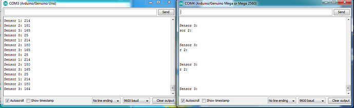

Hello All,
I had assigned some wrong variables. I got my mistake and rectified it. The Sender Arduino Uno is working perfectly fine. I checked on Logic Analyzer and it is sending in the format.
**:strValSensor0,strValSensor1;strValSensor2,strValSensor3;**
The Receiver is Arduino Mega
Attached is .ino file (mega, Receiver) and the Screen Cap of Arduino Uno Serial Monitor
I dont see anything in Serial Monitor of Mega.
Thanks and Regards,
Sachin
![Serial Mon Uno.jpg](https://europe1.discourse-cdn.com/arduino/original/3X/8/e/8e6af8f750d9fbfd684d6d744d9815d694207064.jpg)
[Serial\_Receive.ino](https://forum.arduino.cc/uploads/short-url/7fZjywc9Pl20CbVfqTKBnNrzbk5.ino) (1.68 KB)

```cpp
  SoftwareSerial mySerial(4, 5); //RX, TX
The Mega has 4 hardware serial ports. Why are you doing SoftwareSerial on the Mega?
Why are you doing SoftwareSerial on the Mega without reading the page on SoftwareSerial, and noting which pins on the Mega you can, and can not, use?
<div class="post-metadata">
**Post date:** [February 26, 2019, 2:47pm UTC](https://forum.arduino.cc/t/sending-data-via-software-serial/575998/10 "2019-02-26T14:47:24Z")
</div>
```cpp
if(mySerial.available()){      //Read the values from another Arduino via Software Serial 4,5
//data sent is a continues stream of ":strValSensor0,strValSensor1;strValSensor2,strValSensor3;"
    mySerial.readStringUntil(':');//is string start character
    Serial.read();//skip start character
    String strValSensor0 = mySerial.readStringUntil(',');//read first value
    Serial.read();//skip separator
    String strValSensor1 = mySerial.readStringUntil(',');//read second value
    String strValSensor2 = mySerial.readStringUntil(',');//read 3th value
    String strValSensor3 = mySerial.readStringUntil(';');//Read 4th value
    Serial.read();//skip string stop character
Why are you mixing reads from the (useless) SoftwareSerial instance and the hardware serial instance? Which ONE is receiving the data you are trying to read?

Hello Paul Sir,
Eventually I intend to run the receive code on a Uno or a Nano, hence I am avoiding the Hardware Ports.
_Why are you mixing reads from the (useless) SoftwareSerial instance and the hardware serial instance? Which ONE is receiving the data you are trying to read?_
The Tx of the Sender(Uno) is connected to the Rx (Software Serial of the Mega)
Is this my mistake? I say mySerial.readStringUntil and I am trying to Serial.read? Should it be **my** Serial?
**my** Serial.read();//skip start character

Sir, I connected 11,12 Rx, Tx. I was happy to see the data flowing. Atleast something started working although the
data is meaningless. Looks like something is wrong with the code.
Please see tha attached image.

@OP
The following screenshots indicate that there are some problems with you codes. Fix them and post the screenshots of the corrected program along with the programs.

@GolamMostafa
Sir, Initially I was getting errors for TX (Uno), but figured out my mistake. For (Rx) Mega I tried my best and did everything possible but I couldn't find my mistakes for the Receving Code. I am new to Arduino and don't know where I am going wrong.
