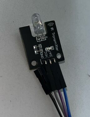

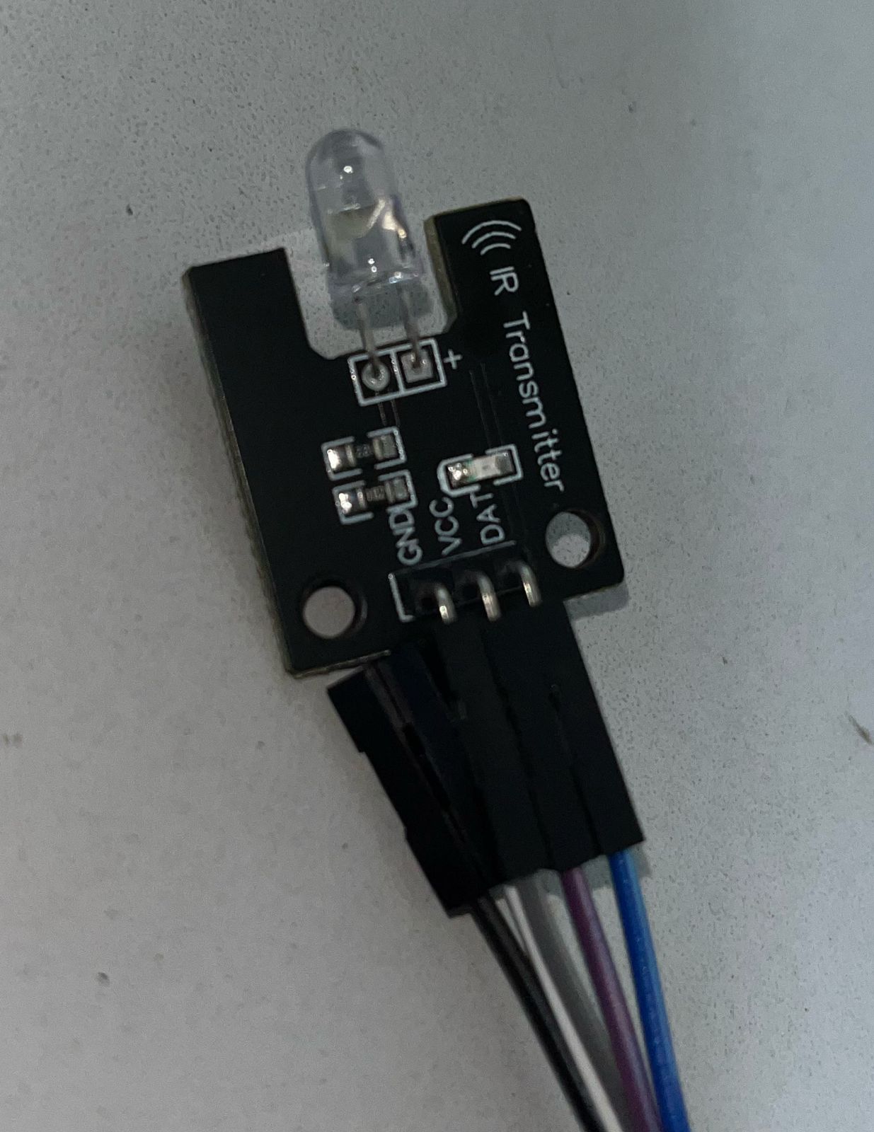

- The hardware is working fine. I tested this same setup with the IRremote library controlling a Sony TV using the native Sony protocol from the library, reading with the same ReceiveDemo example and sending in my code with `IrSender.sendSony(0x1, 0x12, 3, 12);` (volume up) and it worked.
- I can confirme it is possible to "clone" the remotes I'm trying to and actually make them work because I have a proprietary universal remote device that does that (and it doesn't care about any protocol, encoding or whatever, it just asks to press the button on the remote and clones it, and it works with both the remotes I'm trying to clone with Arduino).
So I seem to be able to read the data from the original remotes but can't make it work when sending. I don't know if the problem is actually when sending it, or if I'm reading it wrong. I read several topics here and in other forums where people seemed to have a similar problem and some of them got it working, but they didn't say exactly how, or their solution didn't work for me.

> [@ShermanP](#):
> Also, are you really just connecting the IR LED from the IO port to ground, with no resistor or transistor? I don't know how well that works.
No, sorry, when I said it's "just an IR LED" what I meant was an IR LED with all the necessary components, it's all built-in ina a PCB (Transmitter Module). The receiver is the one literally just directly connect to the board. I'll attach some pictures of the components.
Receiver (connected directly to digital input / 5V / GND):
 ![Receiver](https://europe1.discourse-cdn.com/arduino/original/4X/0/5/2/052675b400a8a29f86cefa35a54ed7f5d64ade0e.jpeg)
Transmitter (module connected to GND / VCC / digital output):
 ![Transmitter](https://europe1.discourse-cdn.com/arduino/original/4X/f/b/a/fba159850cc1fe505822c7d540bb1e1d46203da2.jpeg)
