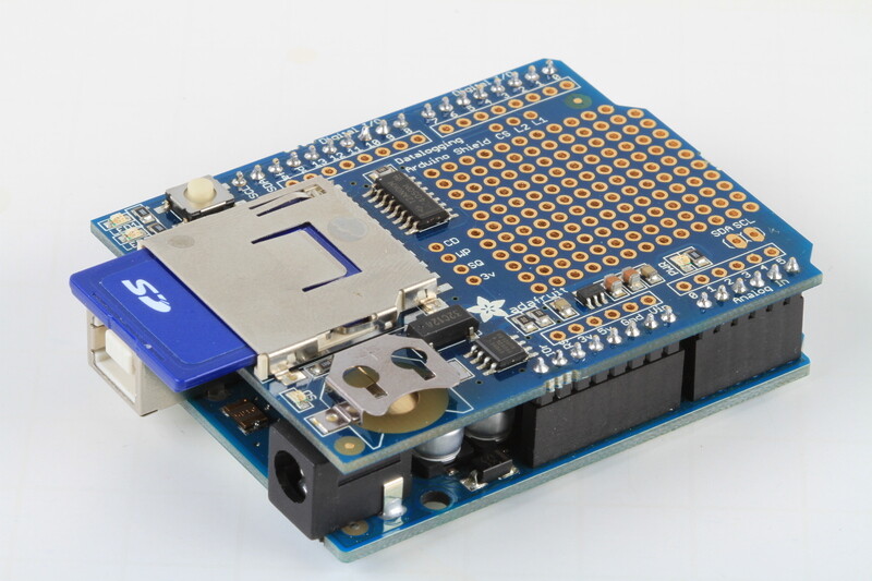

I am working on a final project for my class an I have decided I was going to use the Teensy 3.5 along with Prop Shield With Motion Sensors to get pressure,temperature and altitude readings,
store them into an array, and then dump it all into a text file on the SD card i'm adding when I put them in a 2 stage rocket and launch it into the sky.
The issue I am having is that the code is throwing me errors which I can't figure out. Below is the error messages and my code.
In function 'void loop()':
warning: invalid conversion from 'double*' to 'uint8_t {aka unsigned char}' [-fpermissive]
dataFile.write(pressure);
C:\Program Files (x86)\Arduino\libraries\SD\src/SD.h:36:18: note: initializing argument 1 of 'virtual size_t SDLib::File::write(uint8_t)'
virtual size_t write(uint8_t);
I understand what it is saying but I can't figure out how to fix it. Any help would be greatful!

It looks like your SD card library doesn't have a method for dealing with floating point (double) numbers. Try assigning the value to a long and multiplying by the precision that you would like to keep. For example if you have 12.4351254 and you want to keep a precision of three decimal places, multiply by 1,000 and store the value 12435 as a long (or an int if your range of values is small).
You just need to convert it back again at the other end on whatever is using the data from the SD card.
I'm assigning the values of the arrays? Or the values I get from the sensors, convert to a long by multiplying the values by 1,000 then passing into the array?
It is the value you want to store that you should convert like this.
If you scroll through this thread you will see a function for printing a double to serial with arduino: printing a double variable - Syntax & Programs - Arduino Forum
Also why are you using an array to record the data? why don't you just use CSV and then you don't have to pre specify a size limit to the data taken and it interfaces much easier with other programs (excel).
