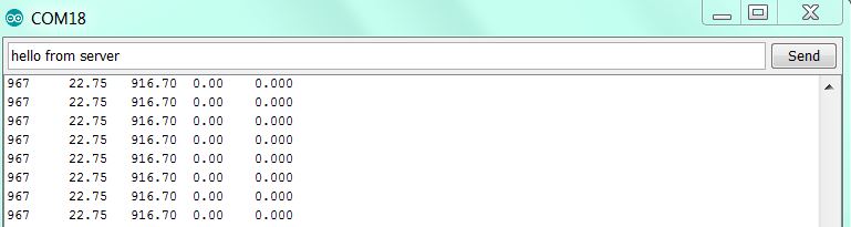

I want to send user input data from the serial monitor of one Ameba to be received and displayed in another arduino. My code for sender side is as follows:

The entire code at receiver side is attached as well. The image attached shows the serial string data to be sent from the sending side. pls help, thanks a lot

Im using this to get measurements from 5 sensors and then sending it via UDP to ESP8266 (acting as AP) which displays those readings on its serial monitor and its already achieved. Now, i want to be able to send some text from ESP8266 back to Ameba from the serial monitor of ESP8266. For that im using this part of code on my ESP8266:
 while (Serial.available() > 0) //check for something to read from serial port
    if (aindex < (arraySize - 1)) // One less than the size of the array
      inChar = Serial.read();   // Read a character
      inData[aindex] = inChar;  // Store it
      aindex++;                 // Increment where to write next
      inData[aindex] = '\0';    // Null terminate the string
    dataToSend = true;
and later sending as :
if(dataToSend)
   Udp.beginPacket(remoteIp, remoteUDPPort);
      Udp.write(inData);
      Udp.endPacket();
    dataToSend = false; //set the flag to false, ie only send when you need to.
    for (aindex=0; aindex < arraySize; aindex++)  //wipe the array
    aindex = 0; //reset the index
