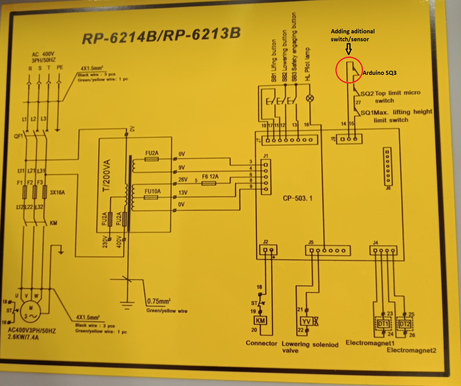

Is the project CONTROLLING the lift or just providing an alarm?
Because I wonder who'd be willing to get underneath a car that's held up by a lift controlled with hobbyist-quality hardware and running code written by:

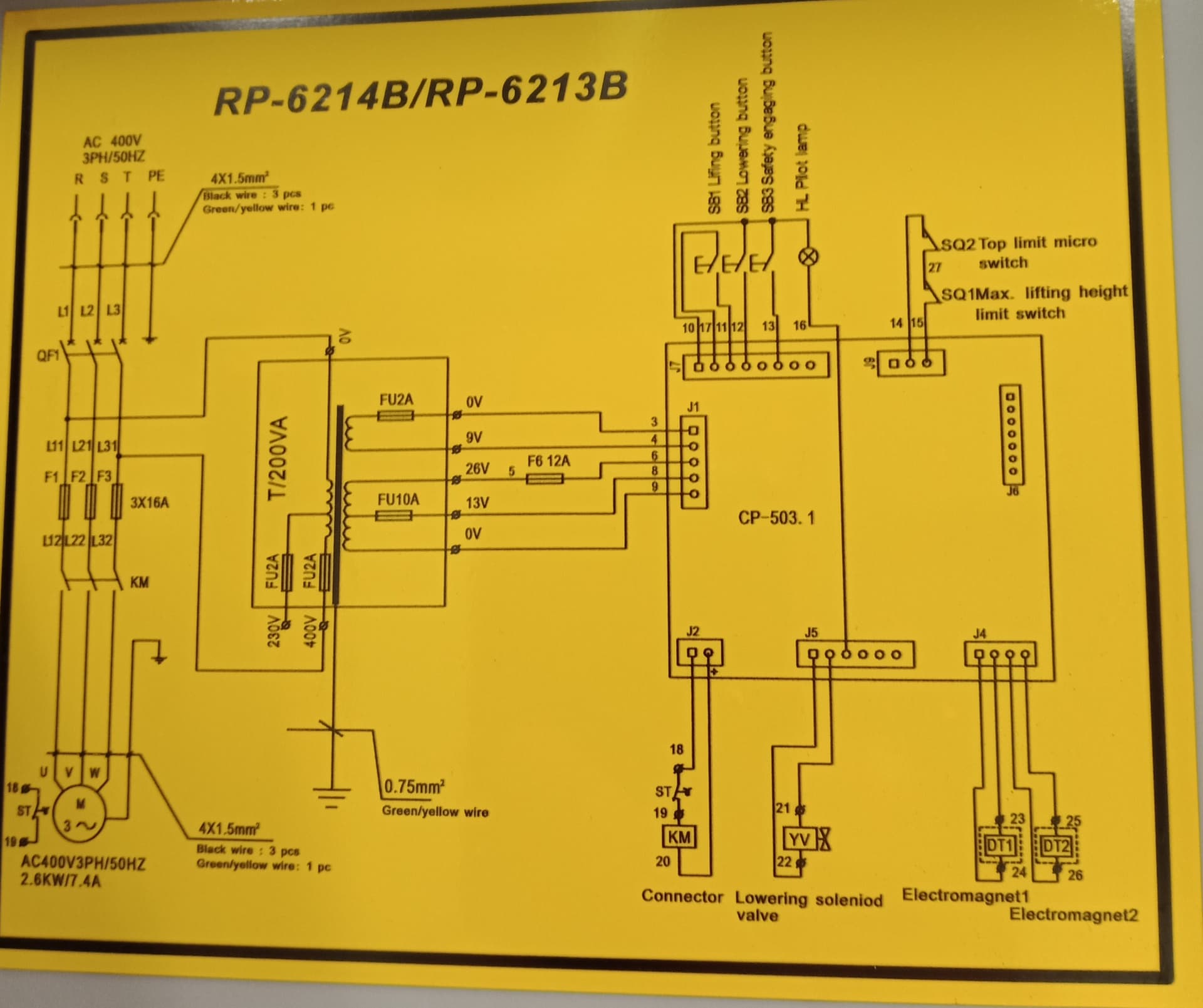

Nothing to wory abouth this project. The lift has 2 sensors/switches that are always on. When you bring the lift up to its final position the sensors go off and lift stops. This does not control nothing else in the lift. In that circuit of two sensors/switches i put beside my switch (optocoupler). So this is completly safe. In case of arduino failing or something else the lift would stop. I can give you the schematics of the circuit for better undertanding.
Here you can see 2 switches SQ1 and SQ2
So if you can imagine...my arduino sensor which optocoupler could be SQ3.
In worst case scenrio the lift would just stop lifting.

I hope you have good insurance, a propensity for modified cars, and willingness to repair the roof.
He is manually controlling lifting and lowering buttons.
The Arduino here only connected to S3 (safety engaging button) in worst case Arduino will not trigger S3 and lift will keep going up but since he is manually controlling S1 he can stop it
I don't think there will be more damage than some scratches on car roof
Thank you alto777. When i come home today i will try this on the real deal "circuit" :slight_smile:
And this is the schematics for the lift with my sensor included for better understanding on what i am doing:
SQ3 = relay (rele) in my code
when the wire 14 and 15 is open the lift stops.
