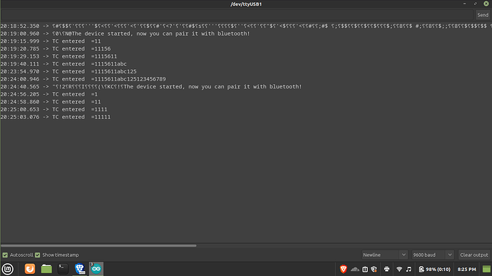

Hey everyone :wave:,
I am making a project based on serial-bt
but the problem is when I assign serial.read to a variable and print it on the serial
it shows one by one digit every time :sweat_smile: :slightly_smiling_face:
I think there is any programming issue
please help!!!
more details are below with code and screenshots

The BELOW image is of the Bluetooth serial (where I enter data.)
screenshot of SERIAL MONITOR (where I see results)
I tried this with many Bluetooth serial monitor

Hey Perehama, :wave:
thanks for your reply
but the solution also has a problem :sweat_smile:
It is not deleting the value it saved before... :thinking: :woozy_face:
when I enter a new value it gets after old value
my bad, there's a bug that tcIndex never gets set to zero...

Nothing is seen on the serial monitor
everything is blank.
HEY, my work is done using this code example.....
