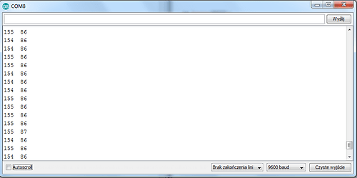

I have a problem with sending two values using serial communication. Sometimes everything works well, but when I turn the potentiometer, my program goes crazy. Any idea?

Have a look at the examples in Serial Input Basics - simple reliable ways to receive data.
...R
I assume that you have the Arduino UNO.
The UNO has one hard UART which is connected with your PC/Serial Monitor.
You have created another soft UART. This soft UART is connected with another PC or another Arduino (UNO/NANO/MEGA/DUE)?
**BTW:**This soft UART is supposed to communicate with another controller that could be a UNO (direct connection) or a HC-05 Bluetooth (direct connection) or a PC via suitable converters (TTL <---> RS232 <----> USB).
