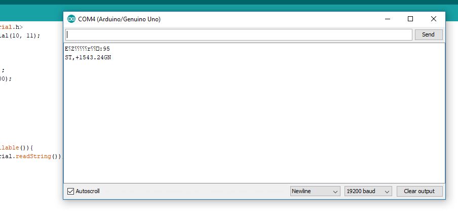

I have two questions regarding serial communication between my arduino Uno and a FX-120i balance:
  1. When ever I read serial data from the balance the first line is always rubbish. After I press the print button the second time, my data is correct. Why can this be?
#include <SoftwareSerial.h>
SoftwareSerial mySerial(10, 11);
  Serial.begin(19200);
  mySerial.begin(19200);
 while (mySerial.available()){
   Serial.print(mySerial.readString());
Output:
See attached picture - Question 1

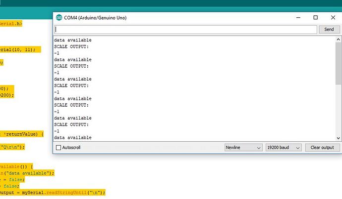

  1. If I try and command the scale to send me data from the arduino I use the following code:
#include <SPI.h>
 float value = -1.0;
int readScale(float *returnValue) {
    mySerial.write("Q\r\n");
    delay(50);
    if (mySerial.available()) {
      Serial.println("data available");
      bool negative = false;
      bool stable = false;
      String scaleOutput = mySerial.readStringUntil("\n");
        Serial.print("SCALE OUTPUT:");
        Serial.println(scaleOutput);
        Serial.println(scaleOutput.indexOf("."));
      if ((scaleOutput.indexOf(".") == 8) || (scaleOutput.indexOf('.') == 9)) {
        if (scaleOutput.indexOf('ST') != -1) {
          //Serial.println("stable");
          stable = true;
        if (scaleOutput.indexOf('-') != -1) {
          negative = true;
        String valueString = scaleOutput.substring(4, 12);
          Serial.println(valueString);
        float value = valueString.toFloat();
        if (negative) value = value * -1;
        Serial.print("Float: ");
        Serial.println(value, 3);
        *returnValue = value;
        if (stable) return 1;
        return 0;
        return -1;
  // wrong scale configuration
  return -1;
int readScaleStableOrUnstable(float * returnValue) {
  int stable = 0;
  int errcount = 0;
  float value;
  stable = readScale(&value);
  while (stable == -1) {
    if (errcount++ > 10) {
      return -1;
  return stable;
  readScaleStableOrUnstable(&value);
  Serial.print(value);

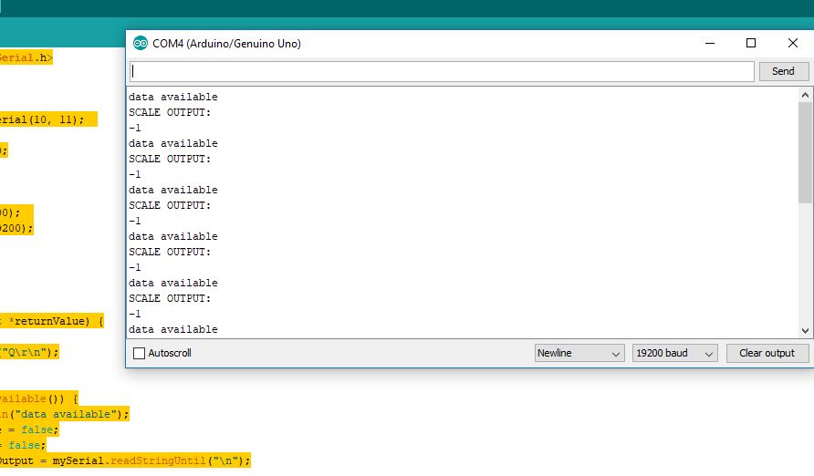

The output can be seen in picture attached - Question 2.
The serial data is available but I don't read anything.
Please advise?

A possible reason for the initial garbage is that the Arduino will have been running and producing output before the Serial Monitor started and that output will have been collected in the PC's serial buffer.

One thing I notice is that I don't think you're handling is the handshaking in the serial protocol.
The datasheet is not terribly clear on serial messages other than commands, I think that after you send "Q" the scale first sends back an ACK (<06>) and then a second message follows with the scale data.
I wouldn't use String objects for this. Consider instead using a char arrays to send and receive data and implementing a state machine to implement the protocol.

Please find my pictures below:
Question 1:
Question2:

thanks for the feedback. I get what you say but what about the fact that if I run the code below, and press the print button on my scale I get the correct output, after some rubbish on the first print, on my serial monitor as shown in the picture below?
SoftwareSerial mySerial(11, 10);
  while(mySerial.available()){
  Serial.print(mySerial.readStringUntil("\n"));
Please don't post pictures of text - just copy and paste the text so it is easy to read. I mentioned this in Reply #1
...R
