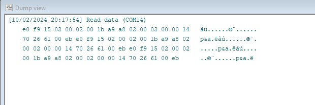

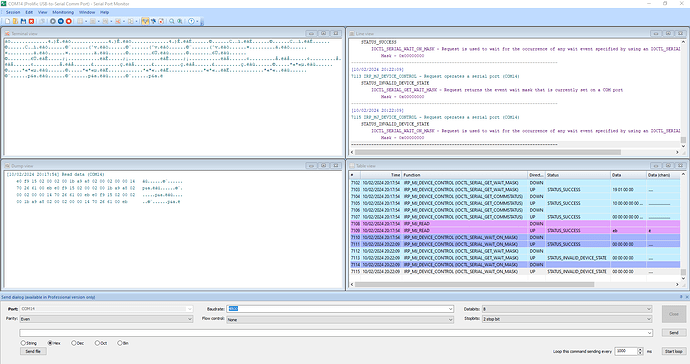

I don't have a way of putting the text directly (other than writing it down..) i'll post a couple of captures from serial port monitor(software for windows for capturing serial communitcations):
In this last image you can see thoose 63 bytes (16 x 3 +15 = 63)
e0 f9 15 02 00 02 00 1b a9 a8 02 00 02 00 00 14
70 26 61 00 eb e0 f9 15 02 00 02 00 1b a9 a8 02
00 02 00 00 14 70 26 61 00 eb e0 f9 15 02 00 02
00 1b a9 a8 02 00 02 00 00 14 70 26 61 00 eb
This is the 21 bytes repeat three times:
