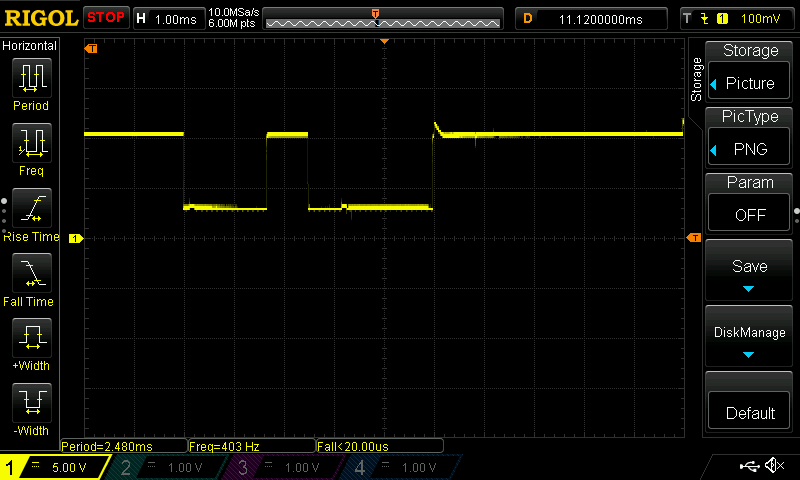

  3. When I hook up an oscilloscope probe in parallel with the TX wire (this was confirmed via testing), when I push buttons on the keypad, I can see definitive square dips in voltage that last anywhere from 1ms - 2.5ms, a few short bursts. But I can't figure out the baud rate, I tried several, and I can't get the data decoded using the 'scope's serial decoder (Rigol DS1054z).

First of all we should find out whether it's a RS-232 connection. The 12V signal level fits into that picture, what's the opposite state voltage?
But RS-232 has a low (negative) voltage in idle state, not +5V nor +12V. This indicates a proprietary connection, not necessarily using the serial asynchronous standard format. Does your scope have an option to decode signals of reversed polarity?
If you can figure out the shortest pulse on the lines, this time would indicate the used baudrate. If it's 0.5ms, the baudrate were about 2kHz (2400 baud?). Can you post one or more captured transmissions? A complete transmission were nice, from which we could figure out both the bitrate and character frame.
Also check whether only one or both lines show pulses at the same time, during a transmission.
Attached is the complete capture for one of the button presses.
With the shortest pulse of 0.8ms, the signal could indicate a start bit followed by a binary "01000111" at about 1200 baud.

b) when I hooked up the TX line (in parallel with the amplifier) to the R1IN pin of a MAX232 breakout (from SparkFun), and the R1OUT line into the RX of a SoftwareSerial port on the Arduino, I got nothing. No data came through at all. Can I not have two things on the line at the same time? When I tried to have it by itself on the line (not hooked up to the amplifier, still no data, but the keypad also did nothing when I pressed the buttons, which makes me think they have some kind of sophisticated, proprietary feedback loop at play here...
osmosis311:
a) do you still think it's RS232?
your scope trace proves it is not RS-232! All is above the zero line. RS-232 trace will be above zero and below zero.
Paul
It still it could be a creative use of RS-232. If you can trim the signal into 0-5V, it may be possible to receive it at RX, at 1200 baud.
