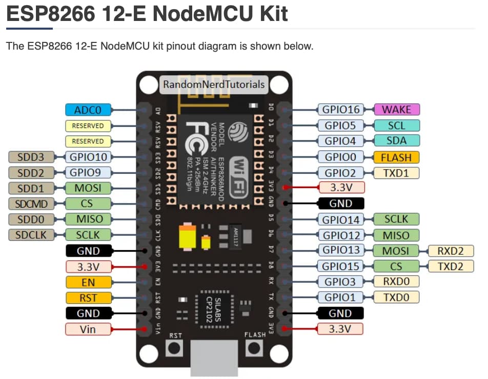

In only one sketch I cannot make the serial monitor to show normal text. only squares are displayed.
Baud rates are set correctly, tried different baud rates, same NodeMCU used on same COM port, other sketches do show correctly, tried different text instead of just the dot, tried Serial.println() but it doesn't make new lines ...
Removed all complexity in the sketch, nothing changed (sketch is working) :

would those conflict with the Serial UART ?
which exact board do you have?
Hi, board info doesn't tell me much, but on the packaging I can read W05703 C4-305 NodeMcu Lua WiFi ESP8266 CP2102 2021-12-09.
I commented out all GPIO-pin related lines, and now it shows indeed the correct text, including line feeds.
Super hint :slight_smile: I will now re-integrate pin by pin to see which one(s) create the problem and will feedback on this post. Thank you.
GPIO1 (the one you called PBH) my be TXD0, the Serial Tx pin

After test it seems that command pinmode(PBH, OUTPUT); corrupts the working of the serial monitor. It is pin D0 = GPIO16 = connected to the onboard LED close to the USB connector. This is a little bit annoying as I use it as a visual check during development, but then I also need the serial monitor for debugging as well. A limitation for this great product.
don't use the Serial pins for something else than Serial if you use Serial :slight_smile:
