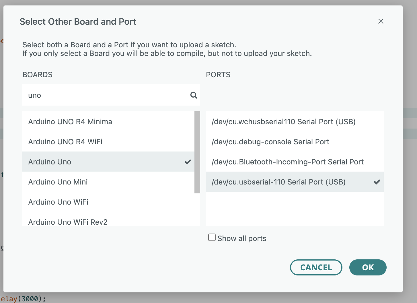

> [@riverrunner06](#):
> "Not connected. Select a board and port to connect automatically."
Did you do that? It should look similar to the following.

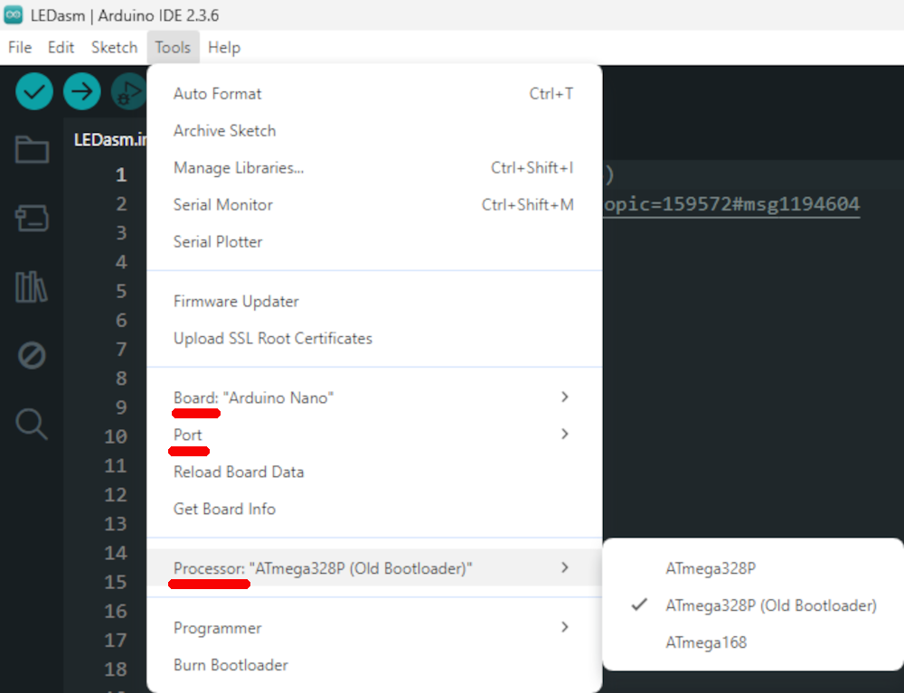

> window at the bottom of the IDE?
One of those windows is the Console (open or close is okay), the other is the Serial Monitor (close when uploading another sketch).
Sometimes when I change to another board or another sketch, I get errors when uploading. I first close my Serial Monitor, then stop and re-start the IDE. I also make the mistake of using a power-only USB cable, so even though I "know" I have a good cable, I get a "data" cable (labeled).
Also check:
IDE \>\> TOOLS \>\> BOARD \>\> AVR BOARDS \>\> your board
IDE \>\> TOOLS \>\> PORT \>\> your port
IDE \>\> TOOLS \>\> PROCESSOR \>\> your processor... and if using CH340, OLD BOOTLOADER
> Not seeing Processor
Can you make a screenshot like this?
 ![proc](https://europe1.discourse-cdn.com/arduino/original/4X/5/8/a/58a47df64408407cae8d6d94d9e7de06f729e36d.png)
<div class="post-metadata">
**Author:** ![sterretje](https://dub1.discourse-cdn.com/arduino/user_avatar/forum.arduino.cc/sterretje/32/391294_2.png) [@sterretje](https://forum.arduino.cc/u/sterretje)\
**Post date:** [July 15, 2025, 6:35am UTC](https://forum.arduino.cc/t/serial-monitor-will-not-connect-or-change-baud-rate/1395680/16 "2025-07-15T06:35:43Z")
</div>
xfpd
There is no processor option when selecting Uno.

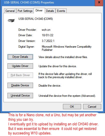

> I read a post that the clone boards can use a CH340 chip and would require a different driver.
Although I've not had this issue for a Uno, I have done so for Nano clones.
I eventually got my Nanos to upload, error message free, only after installing an old CH340 driver. But it was essential to then ensure it could not get restored by succeeding W10 updates.
 ![NanoCH340](https://europe1.discourse-cdn.com/arduino/original/4X/9/2/a/92ad70a154bbea657a18c041291b2c390e9b7ca8.jpeg)
