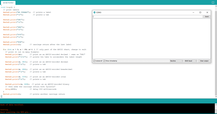

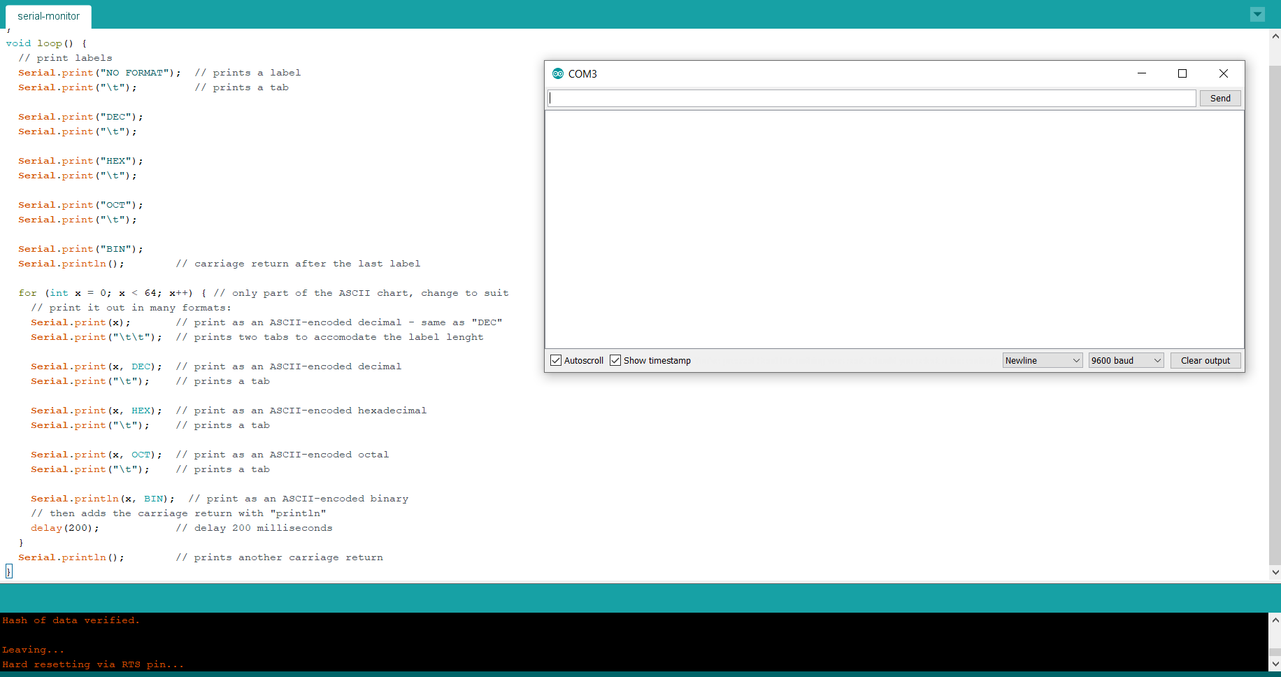

How can I display in Serial Monitor?
I use ESP8266, I tried this code, but it does not show me anything, do I have to make some settings?

Set the serial monitor baud rate to the baud rate you specified in your code.
