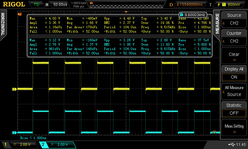

I connect all the wires, open serial monitor, run python script and all seems fine. Python waits for input, arduino is waiting for data on serial, but the moment I enter some character in python, arduino starts an endless loop of displaying its own printed characters.
// edited 10. mar 2013
In this example I entered "a" in python script and arduino returns "RX: a 97" but then it also thinks that string "RX: a 97" was sent to him over serial.

Thanks for the responses, you gave me think that it might not be the code. So I looked at the wiring (disclaimer: I'm better with software than with electrical circuits :slight_smile: ).
I changed the wiring just a little and only the raspberry pi to arduino part. So instead of transistor I used diode, for that small protection.
to:
pi(TX) >-------▶|-----|----[1k ohm]-------[ground]
                      |-----> ar(RX)
With this circuit it works as it should, no magic loops. So the initial problem solved.
However, I'm not completely sure what actually changed, why wouldn't it work properly with transistor and how should I fix it? If I change resistors or voltage in the circuit with transistor, it works even less, or am I missing something. One question answered two new appear :slight_smile:

I understand they are two different things and thats what bugs me. From where is Arduino receiving his own response? I don't believe its pi fault. If he would receive it from pi, wouldn't it try to print "Arduino: RX: a 97" or something different and not just the string he sent "RX: a 97". Even if I remove all serialport.write() lines from python or even disconnect wire from pi(TX), this still happens, the moment arduino receives any byte to ar(RX) it starts the loop.
As I mentioned in my previous post, I got it working the way it should by removing transistor from the circuit and just connecting pi(TX) straight to ar(RX) with 1k ohm resistor. So I assume there is something wrong with the circuit I used (https://pbs.twimg.com/media/A7g86KCCQAAgwds.jpg). And now I'm wondering why this happens only when I add transistor to the circuit.

Well it seems you are just cutting any signal from ar(RX) to pi(TX) -- which shouldn't have been there in the first place. I wonder what the 1k ohm to ground actually does. My impression is that your solution just masks the problem that produced the loopback effect.
Honestly, I'm not good at understanding circuits but the more I look at the original the less I understand what it was supposed to do. Take away the transistors and you have a voltage divider that protects the PI on the ar(TX) -> pi(RX) side (good) and also reduces the voltage on the pi(TX) -> ar(RX) side (why this?).
Now assume that the two GND are connected together, but they are just wires that you call GND without them actually being connected to the GND of either the PI or the Arduino, and you have created a loopback.
Then I'm confused by the transistors and the two 3.3V and 5V sources, but I guess they are not adding any useful effect.

If your question is why the 3.3V to 5V level conversion circuit in schematic A7g86KCCQAAgwds.jpg does not work, the answer is that as soon as the output voltage (V across the emitter resistor, call it "Re") approaches 2.7V (3.3V less Vbe approximately 0.6V) the forward bias current of the transistor approaches zero cutting off the 2N2222 transistor thus limiting the output voltage to around 2.7V not 5V.
The 5V to 3.3V circuit does work because the input voltage is 5V and the maximum output voltage across Re is 3.3V. Therefore the Vbe never drops below the 0.6V junction base to emitter junction voltage of the transistor.
I have attached an Oscilloscope image of the 3.3V to 5V conversion circuit. The 3.3V input is the yellow trace and the blue trace is the output. You can see that the output never excees 2.7V.
