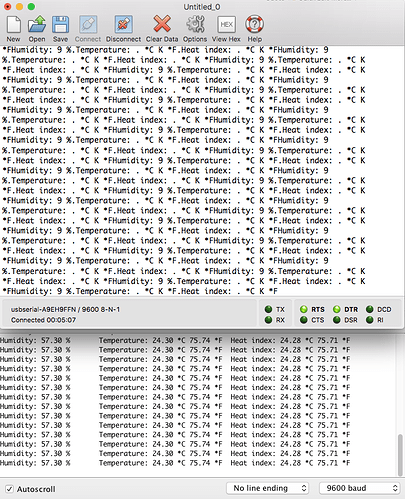

I am trying to send DHT data through an XBee. I combined sketches and ended up with the following:

IT displays the proper data in the monitor attached to the Arduino IDE, but in both XTCU and CoolTerm I do not get the values, merely a 'K'. Please see attached image.
Thank you for your assistance.

Because you are using write instead of print, perhaps?
will try that...
Who's the Man? YOU ARE! (sorry for assuming your gender...)
That worked! Thank you!
You are my favorite person right now...
