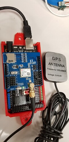

SerialPort for GPS Shield only returning 0 value.
I'm trying to figure out how to get a GPS shield to work. It's my first time actually using a shield but so far I haven't been able to acquire any data from the GPS shield. I'm currently using a Mega 2560 board with a NEO-6M GPS Shield. Currently I'm not sure what could be wrong. Did I forget to do something or did I configure something wrong on the shield itself? I've checked the code and it should be fine. The RX and TX ports are 3 & 4 and are set that way in the code as well.
Any help would be most appreciated. See attached image for details on the setup.

If you are using a Mega, there is no reason to be using Software Serial !
Indeed, on an ATmega 2560 use one of the available hardware serial ports.
The GPS probably needs to be outside before it will get a fix, until it gets a fix there is no 'data' to give you.
I'm trying to figure out how to get a GPU shield to work.
You refer to 'GPU Shield' three times, do you mean 'GPS Shield' ?
srnet:
You're right, I meant to say GPS Shield, my bad. Also what did you mean by using one of the available hardware serial ports? I am currently using 3 and 4. On the shield I can only go up to 7. Perhaps there's something I've misunderstood?
It should work with SoftwareSerial, but hardware serial is much better.
Yes, you should read up on using the additional serial ports of the Mega.
Take everything outside, to where you have a clear view of the sky, and plan to wait up to 15 minutes to get the first satellite fix.
If that's the case, then do I have to always wait 15 minutes just to get an update of the location of the GPS? I hope to use it on a drone, I can't have it retrieve an update of its location at intervals of 15 minutes if that's the case.
No, only for a factory fresh, first fix, or if you have moved the GPS unit hundreds of km.
When turned off, most GPS units maintain a battery-backed approximation to satellite locations that is valid for the current location and for some number of days. With a good approximation, fixes can often be obtained in less than 1 minute.
I've gone outside as suggested and had my program run for at least an hour. Upon checking the debug results, I had never received any value aside for 0.
Try a simple echo program like this, with the GPS unit outdoors. It simply echos whatever comes from the GPS onto the serial monitor.
Post a sample of the output.

This is the updated version of my code. It runs so far, however it hasn't returned any values other then 0 which makes me a bit nervous. I haven't yet though stepped outside to test it, so I'll update the post once I do.
 *10 to GPS Module TX*
 *09 to GPS Module RX*
It will not work indoors.
So I stepped outside for about ten minutes or so. I didn't receive a signal at first so being disappointed set my computer back inside and left it temporarily with the Arduino program still running. To my surprise when I returned I was surprised to notice an abnormality in my debugging, however I still haven't yet received any raw data. It appears that the data that I'm seemingly potentially receiving isn't capable of being encoded by the TinyGPS library that I'm using, although I'm not sure. Either way, the debug showed that after 10 or so minutes, one of the multiple serials I was testing (since I wasn't sure which one would work or not being that I've tested it several times and I'm unsure if I'm just trying to read off the wrong Serial), however Serial1 and 2 would print a debug message that would only be printed when available, however would never print the raw data or the encoded data. Perhaps its a basic mistake I've overlooked? Here's my code and my debug in case anyone is interested, check below for details (ignore the "========[ NO RESPONSE YET ]========" debug, just there to ensure that the program is still in fact running throughout the process).

See debug here - https://pastebin.com/DsF0HeuB
Yes, you seemed to have completly ignored the advice in post #9 from jremington.
Read it again, use the echo program, post the results.
srnet:
My bad, forgot to report yesterday that I tested the echo program by using Serial1 instead of SoftwareSerial and it returned the GPS Start debug message.
EDIT: Just noticed that my phone which I checked the code with didn't fully render the entire list of code for some reason. I'll update my loop method with the code provided and check the results.
I apologize for the delay. So I updated my code, and it checks Serial1, 2, and 3. I'm not quite sure, however it seems all three of the serials get some sort of response from the GPS Shield (at least I believe that is the case). Perhaps the code and the debug messages speak for themselves better then I can.
