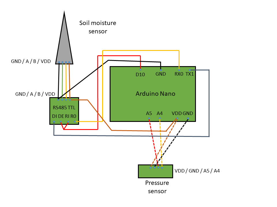

SerialSoftware serial: Nano + Sensor + RS485-to-TTL module problem
Hi there,
I'Ve got a problem - and I think I might be quite close to the solution.
So I have an Arduino Nano to whom a pressure sensor ist attached. This works and is not the issue. Just mentioning it for "completeness".
So my acutal problem is the readout of a SMT100 soil moisture sensor with the Nano.
The SMT100 can be accessed via RS485, so: SMT100 -> RS485-to-TTL -> Arduino Nano.
To read out I use the following code, below:

Now I get a response, see the "comment section" in the code, but it does not make sense to me. Also, there is no difference in the output when setting the CONTROL pin to either HIGH or LOW.
Could you help me out here?
#define TX 1
#define RX 2
Do not use pin 1 as it is used by the hardware Serial interface on a Nano
Okay, thanks.
So now I'm using a software serial. Just to clarify, I'd like to read out both sensors (pressure sensor via analog pins and the soil sensor via the SoftwareSerial).

New problem arose: the SoftwareSerial "is not avialable" error. The print message from the SoftwareSerial is "-1".
Any further advice?
#define TX 7 // D7
#define RX 8 // D8
SoftwareSerial RS485Serial(TX, RX);
If pin 7 (TX) is connected to Rx on the moisture sensor and pin 8 (RX) is connected to Tx on the soil sensor then you have the order of the pins wrong in the SoftwareSerial constructor
True. Also corrected.
Still "nothing".
Write a simple sketch that tests for serial data from the sensor using a SoftwareSeral object and if it is available print it to the Serial monitor
Please provide a link to the RS485 to TTL adapter and the soil moisture sensor that you are using
solved it. I had to first send a command to the sensor, which then returns the value.
Cheers and thanks,
Robert
