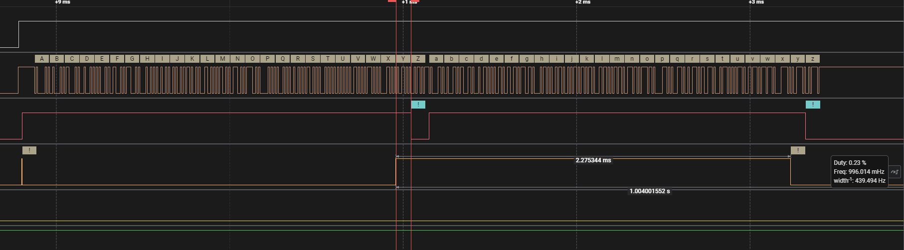

I added some debug prints in the code, which confirmed what I expected.
The call Serial1.availableForWrite() will always return 0.
Digging some into the code base, I see that the Serial objects are using the
UnbufferedSerial class internally. I am not sure where the actual unbuffered write code is, as the UnbufferedSerial.h file shows the write methods as overwrite...
SerialX.flush() does not appear to work either:
That is my expectations is that it will not return, until the Serial transfer has been completed.
Simple sketch:
  Serial1.begin(115200);
  pinMode(2, OUTPUT);
  digitalWrite(2, HIGH);
  Serial1.print("ABCDEFGHIJKLMNOPQRSTUVWXYZ");
  Serial1.flush();
  digitalWrite(2, LOW);
  delay(1);
  for (char ch = 'a'; ch <= 'z'; ch++) Serial1.write(ch);
  Serial1.flush();
My expectations are that the pin 2 should not go low, until the last bits are sent.

Quick update:
I opened an issue on the flush does not flush...
GIGA R1 - SerialX.flush() does not work · Issue #737 · arduino/ArduinoCore-mbed (github.com)
Also was curious, and I am betting that the board does not use the UARTs FIFO buffer either...
  pinMode(2, OUTPUT);
  pinMode(3, OUTPUT);
  digitalWrite(3, HIGH);
  digitalWrite(3, LOW);
  Serial1.flush();
  delay(1);
  Serial1.flush();
@KurtE Hi, does this mean every write to a serial is 'blocking'? It would explain the hi micros I'm seeing with my code that uses Serial. I'm migrating from mega and it's not smooth.
Thanks, and great posts btw
Update: So yep, no buffers writing to Serial. Can anyone share the rationale for using the Unbuffered class? It's crippled my project.
Has anyone already cut a version of Serial that uses a TX buffer? If I need to cut my own, would a rewrite of Serial or bypassing and using mbed directly make more sense?
Thanks
Thanks,
I first ran into unbuffered stuff on UNO R4. I wrote a version there, that I submitted as a PR... But so far it has not been touched.
I thought about trying to convert some of the Serial objects to be buffered. I have not looked at it in awhile, but wile playing with USBHost to Serial adapters, I ran into the issue on how best to setup code to flush the output if nothing added in some time frame... Current solution thee as to use another thread. Keep looking for a simpler solution.
Note: also most of the SerialX.flush() are busted as well. That is many of them do not wait until the data has been fully transmitted.
