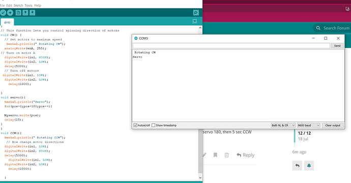

This program is running cw and servo but ccw is not running.

Put a serial print with some kind of "here I am" message in the ccw function to see if it's being entered.

What code in the CCW() function would make the servo move ? Come to that, what code in the entire sketch would move the servo counter clockwise ?
Where do you think the code is going to exit to as there is no Operating System ? If you want it to run only once then put it in setup()
I don't think cw() and ccw() are about the servo, seems there's a dc motor in there on a 293.
Humour (or as the spell check seems to prefer, humor) me: put a serial print message in ccw() to see if the function is being entered.

I added those debug lines to your code from earlier in the thread, got same problem as you.
Then saw that the for loop is coded wrong, added the < and it works now:
for (pos = 0; pos <= 180; pos++) {
edit: Full disclosure, I ran it on an Arduino with no servo or 293 and motor actually within 100m.

Side note: you shouldn't be powering the motor and / or servo from the Arduino 5V pin. You should use an external supply; you may be overloading the Arduino's voltage regulator.
If you try to control speed with the enA pin you will find that it will not work.
From the Servo library reference:
On boards other than the Mega, use of the library disables analogWrite() (PWM) functionality on pins 9 and 10, whether or not there is a Servo on those pins
