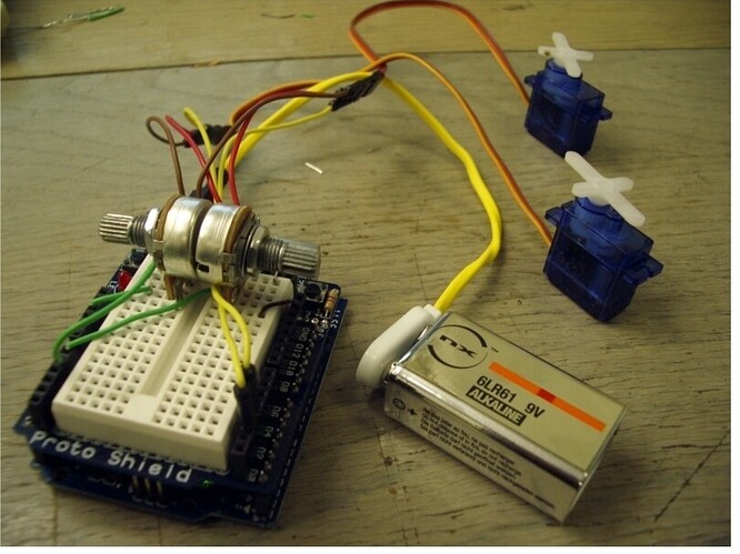

This is my first post here and my forum browsing has been far from exhaustive so bear with me...
I am attempting to control 2 servos with a 3-axis accelerometer.
The servos operate smoothly when controlled by analogue potentiometers.
The serial out from the accelerometer is smooth when servos are not connected.
Attaching one servo disturbs the accelerometer output (all three values) at regular intervals.
Attaching the other makes the whole thing go haywire.
I have considered using a lowpass filter, but really I want to remove the cause of the problem.
Any help appreciated. Code is below.

Well here's a photo of its previous incarnation which worked smoothly. When swapping the pots for an accelerometer things became unstable.
What's the small silver thing, bottom right?
Thats the battery, used when the usb lead is disconnected.

What happens when you power the servos properly from a separate power supply?
4AA should be a good start.
(please, drop the 9V battery into a smoke alarm - that's about all they're good for)
The flutter is still there, even when usb-powered, as tilt2.avi shows.
No, I said "properly from a separate power supply".
You shouldn't be powering one servo from USB.
Do you think lack of power might be causing this then?
I have put 4.8v (and 6.7v) across the servo with the control wire still connected to the digital out, but there was no movement at all. I don't know why this doesn't work.
Did you connect the grounds together?
No I didn't. I'll try it later.
Thats smoothed it out nicely. Thanks for the tips.
