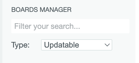

There is a breaking change under way, see the Migration document. https://docs.espressif.com/projects/arduino-esp32/en/latest/migration_guides/2.x_to_3.0.html
A quick fix but problematic is to just roll back your esp32 boards to a release prior to 3, but if you auto update you will need to redo that. You can also do updates selectively both for libraries and boards. See attached pics. The IDE will also no longer auto-update so see 3rd pic
Thank you so much for those answers. Rolling back to an earlier pre v3 board version solved the problem. Compiled cleanly and test sketch working perfectly.
