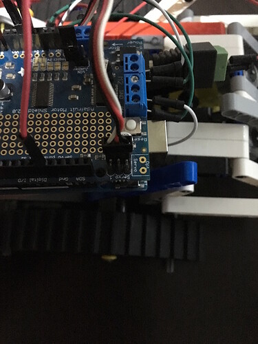

In the original one, I just plug it directly to the headers(the three ones on the right top) , and always works properly.
The problem is when I do the same in the clone board.
If I plug it using wires, to pin 9, 5V and Grd it works fine.
What do you call the "three ones on the right top"? Image please.
A real Arduino has female header for stuff (except for the ISP) and a servo as well. So how does that connect directly?
You´ll see the servo plugged to the headers, directly and works fine!
That's the ISP header, not for a servo. And I'm having a hard way figuring out who it can drive a servo... It has (from top top bottom) Vcc, MOSI and GND. While a servo needs GND, 5V and signal, in that order...
thanks septillion!! I know, but for sure it works fines. So I wonder to know why if in the original is possible in the clone isn´t :frowning:
If you see the picture, in the shield is printed "servo"...

Stop using top and bottom. The Arduino is a square board you can rotate. But if the orientation you're used to is the same as in your picture, aka usb connector up, then you are still pointing (as in, the red arrow in the picture) to a ISP header. The real Arduino has two ISP headers an NO servo headers. So how a servo works on a ISP header is still a mystery to me.

I use a micro servo 9g(I have used differnts types) and works as well with the current coming from the PC via USB as with the one coming from a 11.1V battery. I have used the battery with a 25g servo, with or without the shield-This shield, is an Adafruit motorshield V2- and performs fine.
