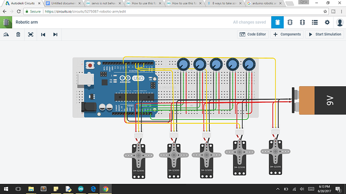

Sorry for the late reply, Here is my wiring diagram you asked for,

Your servos are connected to the arduino 5V pin. Your arduino cant handle that much. Try disconnecting all but one, like someone already said, and see if it works. If so, then its a power problem.
johnfg: Your servos are connected to the arduino 5V pin. Your arduino cant handle that much. Try disconnecting all but one, like someone already said, and see if it works. If so, then its a power problem.
My servos are not wired to the arduino, I have 8, 1.5 volt batterys externaly powering the servos. Only the potentiometers are wired to arduino.

In the schematic it looked like the servos were connected to the arduino. Make sure all the wiring is correct, especially with the batteries.
Edit: In the schematic you didnt include the batteries. Use a voltimeter and make sure they supply the correct voltage (dont use a amperemeter or you'll create a short circuit).

Awesome. I can see the image on that one. No idea why I could not on reply 9. Still no info from you on the brand and model of your servos. The pic shows you powering the servos from a 9v transistor battery. These are mostly useless for powering anything other than a transistor radio. You can expect a large voltage drop once you try to pull the amount of current 5 servos are going to draw. You had mentioned earlier that you had 8 1.5v batteries. My math says that is 12v.
What servos do you have. How are you powering them? 8 1.5v batteries? What kind of batteries? Do you have the ground from the arduino connected to the ground from the servos? (hint, the pic does not show this)

no, the Arduino does not have a common ground with the servos,I am powering the servos with 8 1.5 volt energizer nonrechargable batteries.
