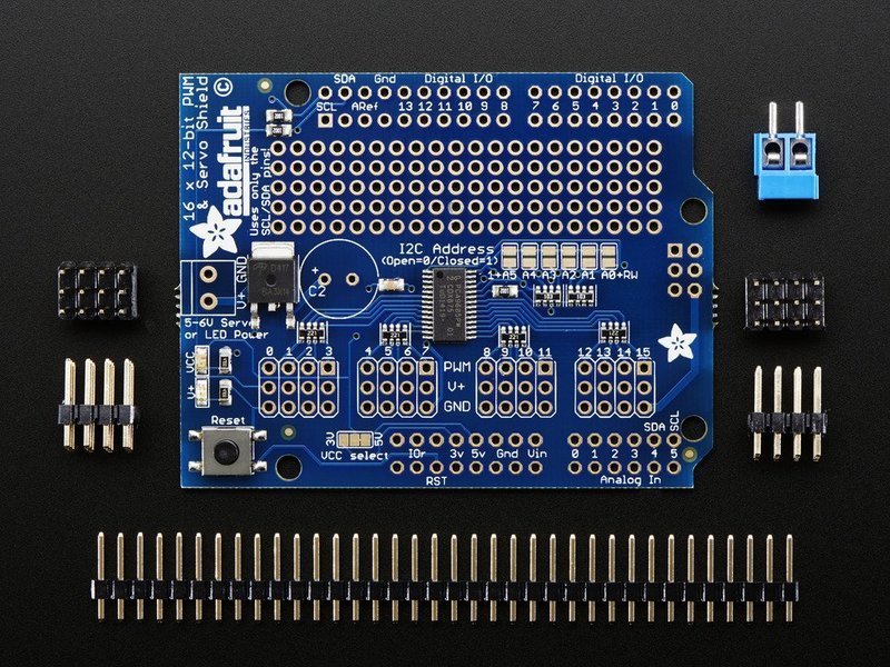

Servo knob over I2C
I'm attempting to use the simple "servo-knob" example but add an adafruit servo shield.
Can someone point me in the right direction, maybe show example code i can study?
TIA
Dennis

This is an example code i used to get basic servo function from an analog 2 axis joystick.
Im trying to get the same over the I2C bus.
I forgot to mention, I'm using boards with the 328p chip, some uno some nano... even a minimosd.
Can you please post a link to the shield?
Knowing Adafruit there should be a well documented tutorial on how to use their shield, possibly a library for it and examples.
Have you looked there?
Thanks.. Tom... :smiley: :coffee: :+1: :australia:
This one ? https://www.adafruit.com/product/1411
Have you looked at and followed the tutorial?
Thanks Tom and Koepel, that is the servo shield i have a clone of.
I have followed every tutorial even closely related. I can talk to the shield over I2C, i can adjust the end points, i can adjust how many servos and which one it starts with, it sweeps each servo, first fast then slow.
So i have two working sketches, one using a pot to adjust the servo angle, and one that blindly sweeps endlessly.
I just can't seem to find an example using a pot to adjust the servo angle over I2C.
It might be buried in ladyada's circuit python.... not sure what python is (I hate snakes).
You say that you want to use it over I2C, do you mean that you are using the Adafruit library for the shield and want to add a potentiometer to it ?
Then your question is about using the Adafruit library. I don't care that there is somewhere a I2C bus between the sketch and the servo motor :man_shrugging: The Adafruit library deals with that.
Can you show both sketches that you want to combine ?
Ignore the Python code. That is a different programming language and it is not used in the Arduino IDE.

This is the adafruit code I'm lifting the serial.write stuff from.

This is how i have started to join the two.
This is an example of me not knowing what im doing so please feel free to ...
This code gets me correct looking responses on my serial monitor (between 0 ~ 1023 on two axis) as i vary the position of the joystick.
Obviously not looking for a "do it for me" solution.
Again, thanks ALL for your input.
Dennis
@dronemonger First, fix this:
 for (int i = 0; i < SERVOS; i++) {
    //Attach the servos to the servo object
    myservo[i].attach(servo_pins[i]);
  for (int i = 1; i < SERVOS; i++) {
Should be:

@camsysca, dronemonger is trying to add a potentiometer with the Adafruit shield (clone) using a example with the Arduino Servo library.
As far as I understand, there is no Servo attached to the Arduino board. The Arduino Servo library should not be used.
@dronemonger do you know that the Arduino Servo library can control many servo motors. You don't need a shield.
The Arduino Mega is also of the AVR family (just as your ATmega328P) and can do this: ServoOverdone.ino - Wokwi Arduino and ESP32 Simulator
Can you draw a picture of what you use ? with the 5V and GND lines to power the servo motors. The 5V pin of a Arduino board is not strong enough for a servo motor.
Then I bow out.
@dronemonger Trying to get an idea of what you really want. Does the following describe your target intent?
"I want to drive two output signals from the Adafruit pwm/servo shield; each pwm output's pulse width shall be proportional to the setting of a potentiometer, with different min and max pulse widths"
@Koepel, i do know the servo library will control many servos, I'm also aware the 328p's 40ma current limit doesnt allow for even the tiniest servo.
@Camsysca, yes thats is precisely what I'm trying to learn how to do, but over I2C.
I'm not sure what sketch i should have started with now. Again, this is really a learning excercise for me, I've had many problems in the drone world attempting com over I2C. I see its probably simpler than im trying to make it.
I ultimately want to be able to understand this well enough to tap out an entire scetch from my knowledge.
Thank you
Dennis
It's not the pin current you need to worry about, Dennis. The 5V power to the servo must NOT come from the Arduino, as a servo can draw in excess of an ampere in some circumstances, and the 5V regulator on the Uno cannot source that.
But the library takes care of that. Are you saying you want to learn to do the low-level communication via I2C? That's what libraries are ideal for, as you'll be hard pressed to replace a library to do the job without an oscilloscope, and a good bit of time.
