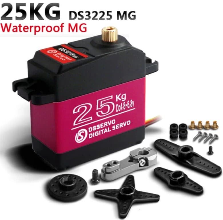

I am using an Arduino Uno Wifi rev 2 with a CNC shield. One of the operations is to move a servo through 120 degrees and back. The problem I have, is that sometimes the servo works faultlessly. However, on other occasions I can hear a ticking sound and the servo doesn't move. By changing out the servo for one of the same brand and spec, I get a faultless movement. I change back and sometimes it works and sometimes it doesn't. Both servos are brand new. Can this be the Servo,h library causing the issue?

<div class="post-metadata">
**Author:** ![TomGeorge](https://dub1.discourse-cdn.com/arduino/user_avatar/forum.arduino.cc/tomgeorge/32/215261_2.png) [@TomGeorge](https://forum.arduino.cc/u/TomGeorge)\
**Post date:** [May 22, 2023, 8:17am UTC](https://forum.arduino.cc/t/servo-library-problem/1129603/7 "2023-05-22T08:17:10Z")
</div>
> [@paymentupfront](#):
> Is there another library I could use
You have proven that it is not the library, by swapping servos and one servo always has the fault.
What servo are you using?
Can you please post a link to data/specs, where you purchased the servos?
I'm suspecting you have got the cheap SG90 servos with plastic gears.
> Is there another library I could use with the Arduino Uno Wifi that I can try which would eliminate a software issue?
... or you could try
```arduino
servo.attach(pin, min, max);
Where min = 1000 and max = 2000 for a generic [SG90](http://www.ee.ic.ac.uk/pcheung/teaching/DE1_EE/stores/sg90_datasheet.pdf) servo.
If using
```arduino
servo.attach(pin);
Here, the default min = 544, max = 2400 could be beyond the mechanical limits, therefore ...

Glad you've got it working.
Just to mention, all you needed to do is use `servo.attach(pin, min, max);` in setup. The library internally uses constrain for both the `write()` and `writeMicroseconds()` functions.

What this points out is that the servos that you have, have the ability to physically move more or less than 0 to 180, even though being signaled to go 0 to 180.
Not all the one brand/model are the same.
Glad you got them working properly rather than having to purchase more precise servos.

Thank you everyone. Here are the specifications.
 ![image](https://europe1.discourse-cdn.com/arduino/original/4X/9/5/b/95b6215694564c90aa70ed6cc6840400b76c354c.jpeg)
 ![image](https://europe1.discourse-cdn.com/arduino/original/4X/d/e/a/dea506695e2c6385b4908ad5bf0568ea784b4450.png)
