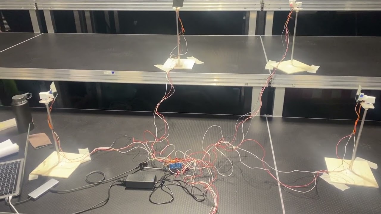

So, A few videos after tests.
So this is how it looks after modeling with the first code:
sometimes the motors did have 1 angle response, sometimes they didn't.
this is the system playing 2 cues in the second code:
sometimes it was right sometimes off with a few tweaks, but not reliable and not efficient to tweak.
and this is the system with lights open moving, seems to be balanced:
thought about changing the 3d model.
but i think changing the motors will be a huge step forward..
Am I right?
The repetition to the same place, reliability and so on?
