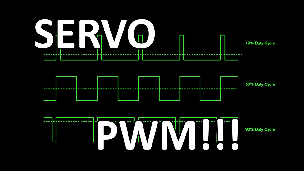

To learn about servo-signals and how non-continuos servos work
For a continous-rotation servo you have to switch back and forth between
end-position and middle-position.
the shortest pulse-length is 1000 microseconds
the shortest pulse-length is 2000 microseconds
The 180 degree non-rotation-servo needs signal
turn to 0 degeers 1000 microseconds
turn to 180 derees 2000 microseconds
turn back to 0 1000 microseconds
the continous-rotation-servo needs
servo is stopped = not turning 1500 microseconds (1500 = middle-position)
servo rotating clockwise 1000 microseconds
servo rotating counterclockwise 2000 microseconds
servo stopped 1500 microseconds

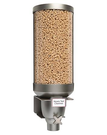

I attached the motor to the silver dial, and then everything will be mounted to the wall in reverse (the dial will be against the wall). When it spins the cereal will dispense. Whatever dispenses in the 360 degree turn is a serving.. If someone wants 2 servings, it will be another 360 deg turn and so on. I hope that helps

Well
if you would have posted this picture in your very first posting
and if you would have explained that you need to rotate this cross-handle always clockwise 360 degrees to pour out the cereals
but just a moment! I'm still unsure if pouring out the cereals is done by turning the crosshandle always clockwise and as soon as the clockwise rotation stops pouring out stops
or
if this corsshandle is connected to a mechanism that is opened by turning the crosshandle 90 degrees or 180 degress clockwise
and to close it again the crosshandle has to be rotated into the opposite direction = counterclockwise???
And if you would have posted information about the estimated force / torque that is needed to make this crosshandle turn
  • can be easily rotated by a 2 year old child
  • can be easily rotated by a grown up with not too much force
  • can only be rotated by a grown up person with quite some effor
or if you would have done a measuring connecting a small rope to one of the handles and then using a small bucket with a handle filling in some water and see with how much water = how much weight is needed that the crosshandle starts to rotate the torque can be calulated.
torque = weight in kg * 10 m/sec² * distance from rotating midpoint to rope
This could be used to choose a suitable motor.
best regards Stefan
Hi
To answer, anytime you turn the handle, CW or CCW cereal pours out UNTIL you stop turning the handle
It also cannot be done easily by a child, but with some (little) effort by an adult
