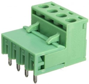

i'm use this for power instead of breadboard.
