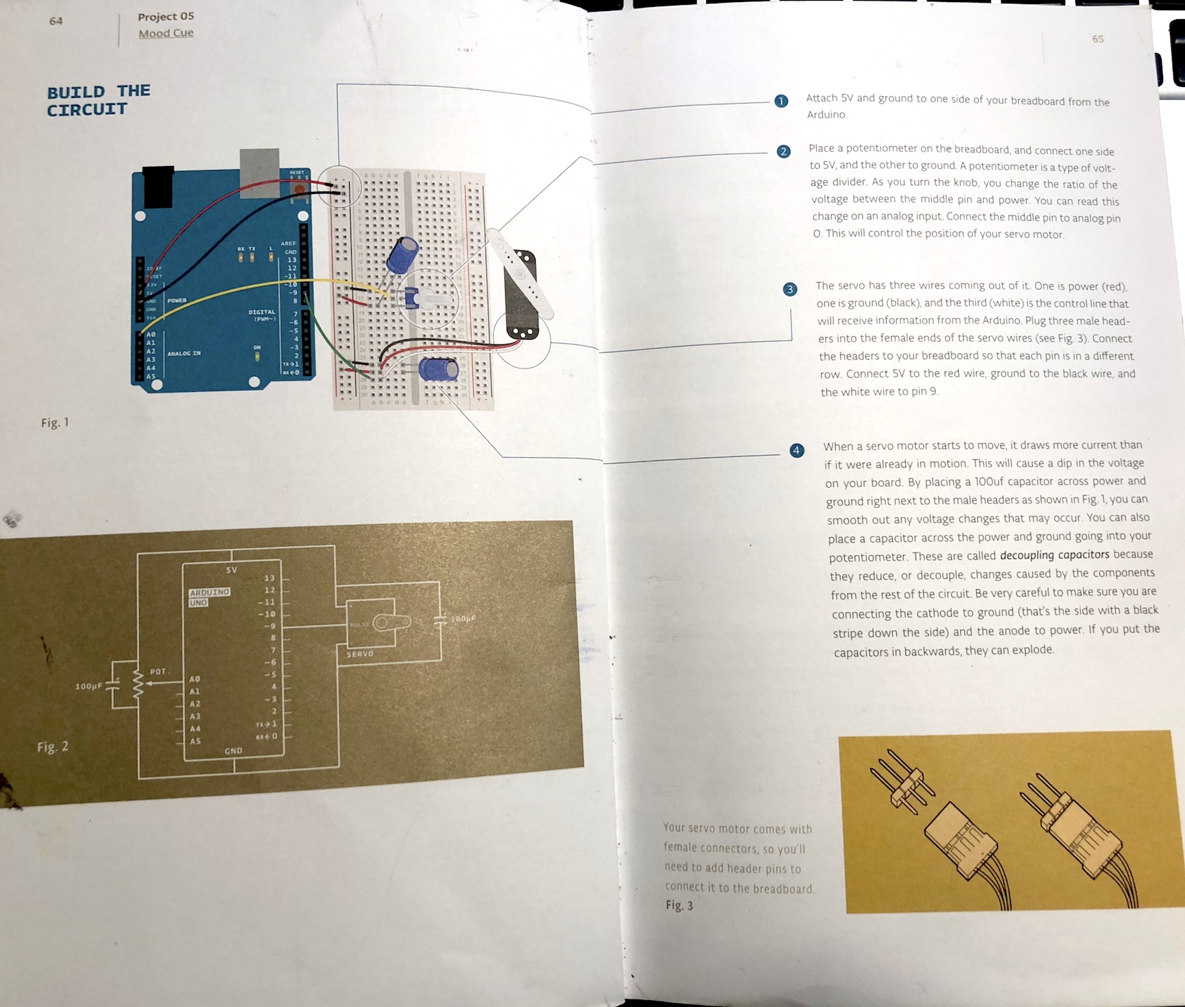

I am also using the 5V pin because that is what the instructions said to do.

Attached are the pages from the Arduino Project Book that explain the set up of the circuit.

The problem is that the connections on that sort of pot are not ideal for fitting on the Solderless bread board.
You could try moving the pot along another row. Or moving the wires in and out. It is likely to only be the center connection of the pot because a loose connector on the other two would just drive the servo to one end or the other.
The real answer would be to solder short wires into the pot connectors and put in the wires to the breadboard.
The instructions were written by someone who does not understand that the 5V pin cannot safely power any motor or servo.
Do not follow those instructions, as you may damage the Arduino. Instead, use a 4xAA battery pack to power the servo, and connect the grounds.
