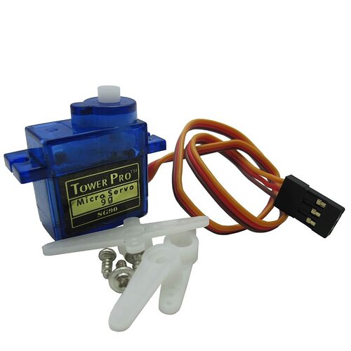

I'm playing around with some servos 9g SG90:
Weight: 9 grams
No-load speed: 0.12 seconds / 60 degrees (4.8V)
Stall torque of 1.2 - 1.4 kg / cm (4.8V)
Operating temperature: -30 to +60 degrees Celsius
Dead-set: 7 microseconds
Operating voltage: 4.8V-6V
Fig. 1.1 Servo SG90
So I got a MPU6050 getting some data in Ax. angle Degree and as the servo is in degree to
i wrote a simple mapping code:
int servoYax = map(compAngleY, -60, 60, 30, 150);
 myservo.write(servoYax);
Now as you know I can get exact angle of the servo by code.
My question is:
1. Can I get back from the servo angle degrees? for example to spin the servo and get
data on my serial monitor. Is that possible?
No. The servo has no way to feed that information back.
Then how the servo lib. knows exactly where is the angle deg. on the actual servo?
To put an exact deg. on a servo you need to have info that the servo is in that exact position.
It doesn't know. The arduino just sends a command signal on a pin. The arduino doesn't even know if a servo is connected to it or not.

So then it's all about the inside micro chip and pot. The arduino chip for example send (90 deg) so
after that the inside servo chip read the arduino and read the pot inside the servo and spin it
right in the exact angle.
There is no other way as i think.
Correct, there is no feedback from the servo. The only way to get feedback would be to take it apart run another wire from the pot back to Arduino and figure out position based off of analogRead values...
