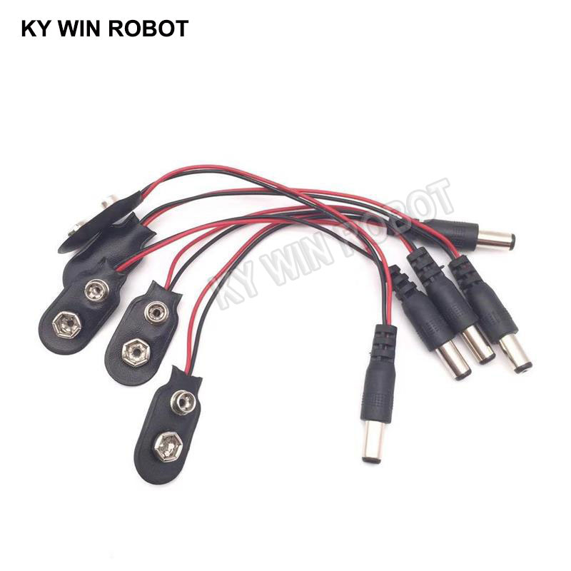

I am using a 9v akaline energizer battery and connect it to the ardunio using a 9v dc adapter, is that considered a pp3 battery?
Would using 4 akaline parnasonic AA batteries connected to a 4 slot battery holder solve the current problem?
This is a "PP3":
Do you mean this?
Far more sensible.
But you have to connect it to the servo power connections, not the "barrel jack" on a UNO.
The "shield" on the video has a barrel jack that apparently powers the servos and UNO given a 5 V 2 A mains adapter. 6 V (or more) from four alkaline dry cells is too much for the Arduino, OK for the servos. four Ni-MH rechargeables would be OK for both.
I see, thank you so much for your response. It turns out i have been using the pp3 battery and the 9v dc adpater i meant is the same as the picture you sent.

And if this is what you mean by a "9v battery":
Then you are somewhat unlikely to overload the regulator anyway. :grin:
Yep im using that kind of battery, sry i deleted the other reply i didn't know there was an edit button.
