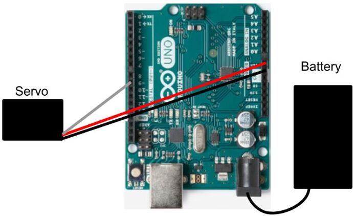

I've attached a schematic. I tried using a smaller step size but servo still isn't responding. Like I said, I've used the 9V battery before to power the servo and I never had any problem.
So, you are powering the servo from the Arduino voltage regulator.
OPs image from reply #8
This is a very bad idea.
It may work for a small servo pulling very little current.
As soon as you ask the servo to do any real work, it will overwhelm the onboard arduino regulator and the whole system will shut down. Best case.
Apparently, asking your servo to move from 1 to 179 is enough of a demand that it shuts down your arduino.
Go ahead and power your arduino from your existing battery.
But get a proper power supply for the servo.
