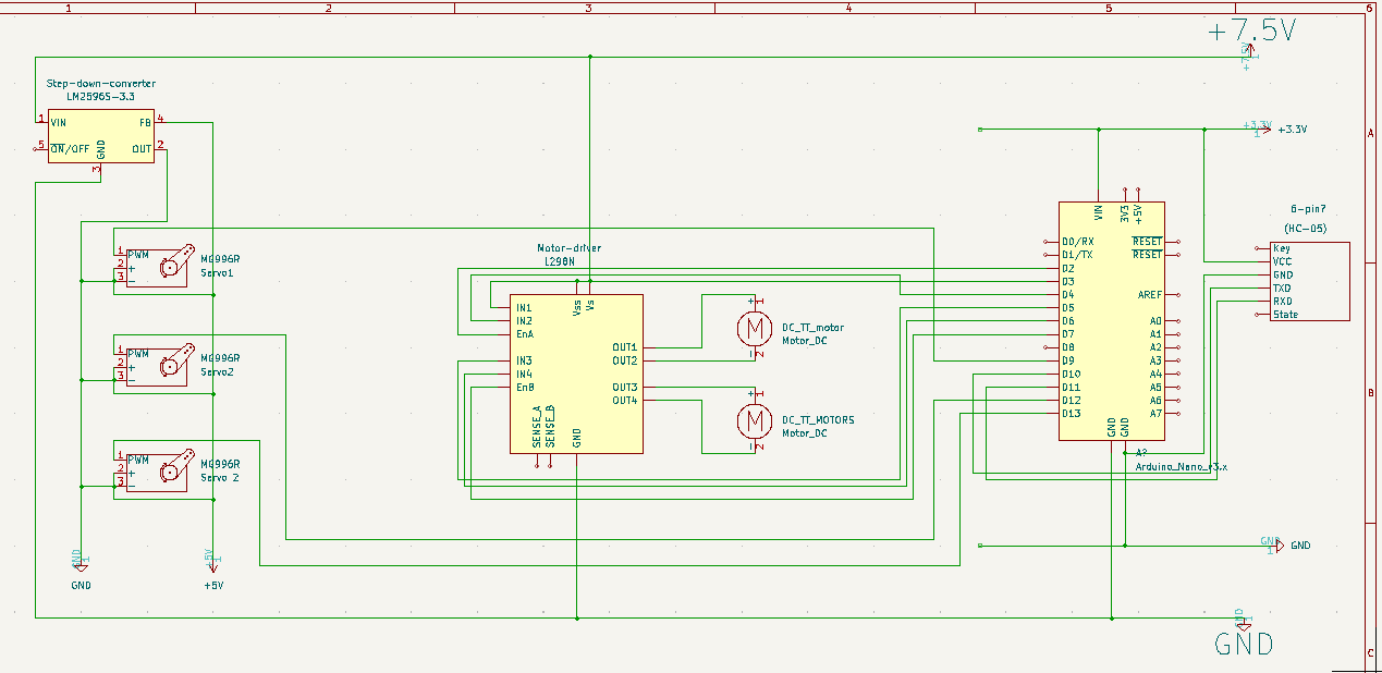

I forgot to mention, I'm using a LM2596s step-down buck converter. Here is an updated schematic. I used kiCad for this:

The new diagram still doesn't make it clear if the negative end of the battery is connected to the Arduino ground.

I plugged the negative end of the servo power supply and my Arduino Gnd into the negative side of the power rail on the breadboard. Does this qualify as a connection?

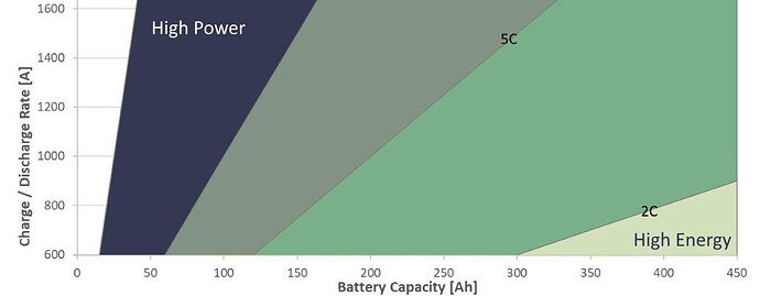

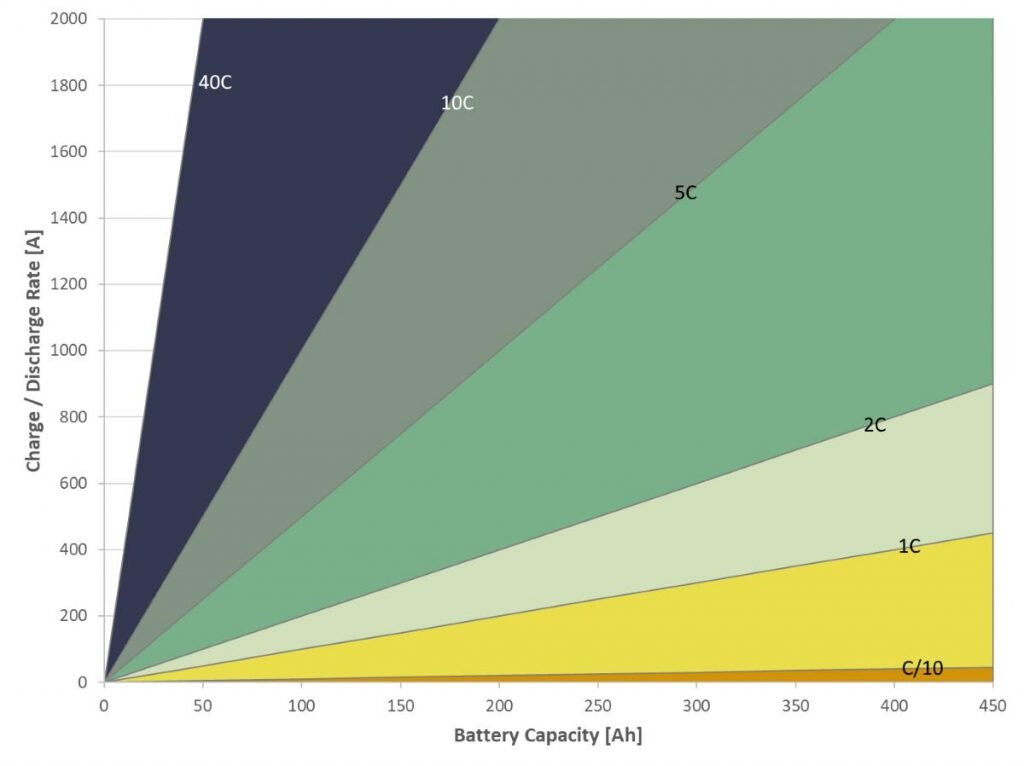

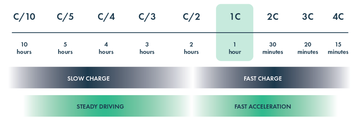

The Li-po battery stores 2200mAh. The discharge rate of the li-po is actually 30C so 2.2 Ah * 30 which is equal to 66. Other posts explained that in order to calculate the current a li-po can deliver is to multiply it’s storage by the C rating. I know you are saying C10 is something else, but I can't find the answer.
C10 means that if You pull 2200 mAh / 10 = 220 mA You will get 2200 mAh of energy from the cell. If You use C20, 110 mA You will get more energy out. Using 440 mA You will get less energy out of the cell.
All batteries have some internal resistance that burns energy. The higher current the higher loss and the lees energy coming out.
The maximum current possible to use is not told by the capacity data, the mAh figure.
Edited to add that none of this seems to be germane to the problem.
A point of clarification:
You two are saying similar things, but with somewhat different nomenclature.
The "C" rate is the discharge (or charge) rate in amps divided by the battery capacity in amp-hours. It is usually shown as unit-less.
For C rates greater than 1, the usual nomenclature is, for example, 10C, which corresponds to a nominal 22 amp rate from 2.2 A-hr battery (22/2.2 = 10)
And for C rates less than 1, it is often expressed as the letter C followed by a fraction (including the fraction symbol). For example, a C rate of 0.1 is shown as C/10, which corresponds to a 0.22 A or 220 mA rate from a 2.2 A-hr battery (0.22 / 2.2 = 1/10)
And @Railroader is tacking on another concept, which is that less energy is available at high discharge rates. Which is true, due to internal heating and other effects.
Another tacking, yes, but I never got the impression that the capacity tells anything about the maximum current the battery can deliver/ is made for. A quick and easy assumption is: the higher currents used, the shorter life of the battery.
