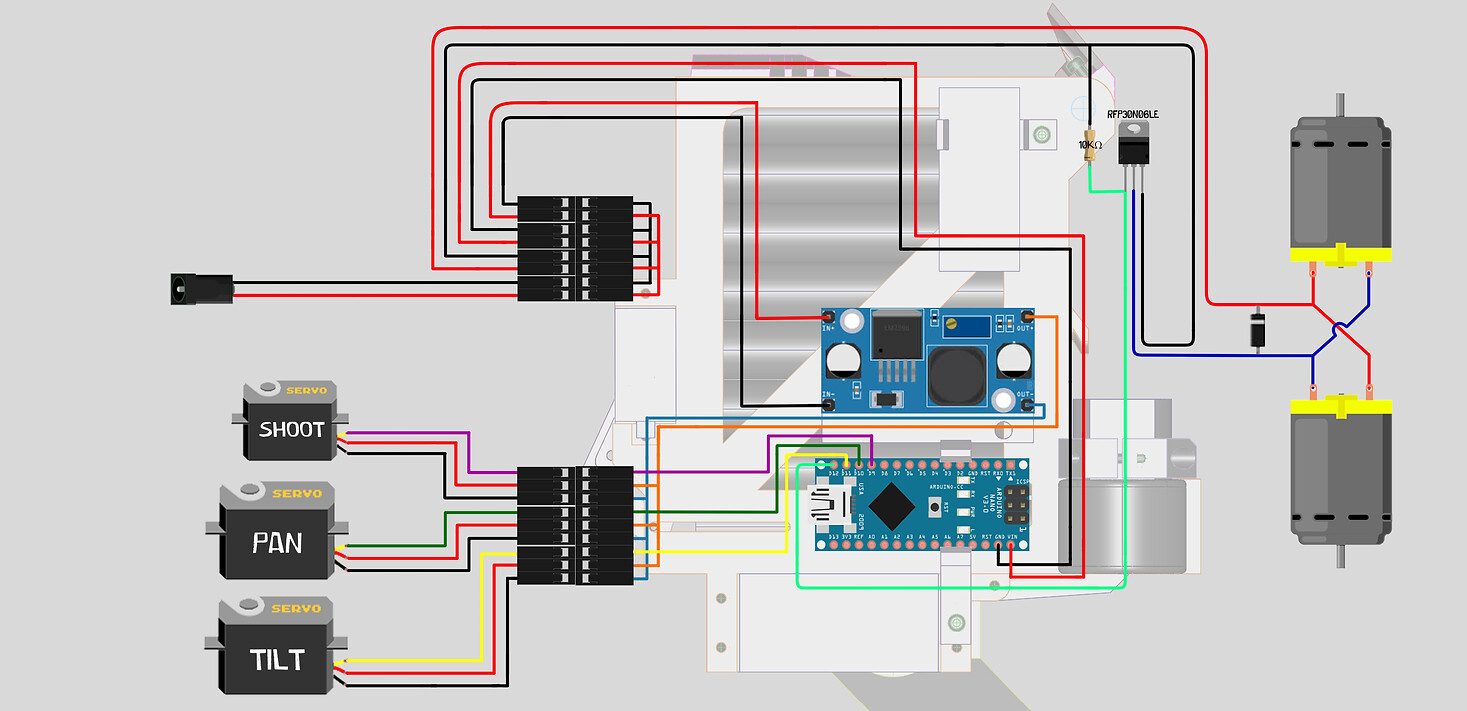

I'm building a turret using arduino, and ran straight into a wall here, the servos won't react to the joystick input, and I'm trying to find out if it's a code issue.. its kind of a pressing matter, since the project is due in a short time period.

did you give up on bluetooth ?
do you have enough power for the motors? (not through the arduino, right?)
yeah, every group did, no one got it to work, and with a dangerously approaching deadline, continuing with bluetooth wasnt worth it
also used a 9v battery, the motors in front started running, the servos wont.
OK - I think you had bad modules. Since the other post relates more to the remote control, let's keep this discussion here
did you try a simple sweep code to see if the circuit is OK?

the servos should move directly based on the position of the joystick - it's not incremental so movement can be harsh
do you think the sweep code will work without having to pull the whole construction apart?
yes no need to remove anything. that's actually the point verifying that your circuit is OK (as the code is OK)

if the servos don't move, you have a circuit issue. Possibly on the power side.
ok, so the sweep doesnt work, thats a circuit issue?
Is there a ground connection between the servos and the Nano.
I don't see one on your wiring diagram
I don't think so, no
is this scheme still what you have?
pretty much, just with a joystick in place of the bluetooth module.
what's the power supply connected to the jack?
do you still have a voltage adapter ?
best would be to post a new schematic
9v battery
the typical 9V batteries are not suitable for multiple motors. They don't provide enough current.
what would you suggest?
use 4 or 6 AA batteries in series to get the right voltage for example
