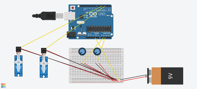

OP's image. See this handy image guide
Yowza! You have 9v running across your pots! I bet they got hot!
I think you should look at the wiring diagrams for the knob tutorial.
It poorly uses the arduino 5v for the servo power. Keep your separate power for the servo instead.
But it properly used the arduino 5v to run across the pot.

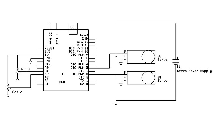

Please look at this circuit diagram, note how the potentiometers are connected.

vinceherman:
9 V over a 10k pot shouldn't make the pot smoke. But the swiper of the pot will pick anything between 0 V and 9 V for your Arduino pins to read. Not good to read 9 V, when the Arduino itself works on 5 V.
