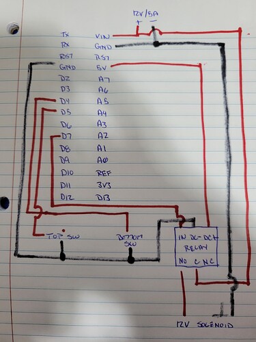

I am trying to make a solenoid control for a maple sap tank. The tank is under vaccum to draw the sap into it like a straw. I have two float switches inside to control when a solenoid valve opens to allow air in to drain the tank and to close the valve to return the tank to vaccum. I am using a Alamscn mini Nano v3.0 with a ATmega328p chip, screw down base for the Nano, and a one relay module. it is powered by a 12v, 5A power supply. I would like to have the Nano veiw the switches as momentary push buttons, and I cannot see why that is not possible, both are just switches. The program I wrote compiles good and uploads just fine. The inputs seem to work like they are supposed too (pin 4 bottom switch, pin 5 top switch), but the output (pin 7) does not send any signal to the relay to open and close it. Always read 0v. What i got is below.

Without a schematic, it's hard to say what might be going on.

tried second board, it also has nothing coming off pin 7.
