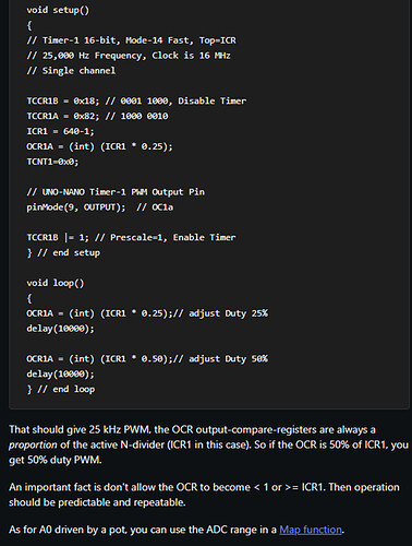

I want to pass values into these registers in order to make a frequency oscillator using my Arduino R4 and all the examples I see are people simply passing their desired hex / int's into their respective registers and voila. When I try to do the same however, I get an error saying that the values are undefined. Here is what I am trying to replicate. I am using the R4 registers, not the ATmega registers FYI.

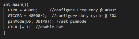

After reading the datasheet this is what I think it should look like.
What happens if you put the code in the setup() function of a normal Arduino sketch ?
By using your own main() function you have bypassed the one in the Arduino environment
For reference, this is the main.cpp file used by the R4 cores

"Compilation error: 'GTPR' was not declared in this scope" as well as the rest of the registers.
So I ended up defining a pointer that points at the registers address, then appending to that address however I am not seeing an output. No clue where to go from here.
