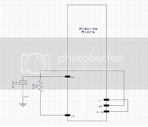

Well, as of late last night, the basic capacitor measurement function was working. Whew! Converting Nicks code to work on the Micro turned out to be a bit of a chore. Getting all the registers on the Micro correct took lots of reading and double checking the datasheet for the ATmega16U4/ATmega32U4.
I do have a question, it's not pressing but I don't see any reason in my code for the first reading taken will always be about .....well, let's just say wrong! and I can't blame it on contact bounce because upon reset with a cap already connected, the first is still wrong. (normally too large).
Next I have to order the precision resistors so I can set up all four ranges but in the mean time, here is what I have so far. Both code and hook up have changed.
Tested and working on Arduino Micro
Keshka Kotera 8 Feb 2016
#include <Math.h>
#define Charge_pin4 12 // pin to charge caps
#define CapPositive_pin 7 // pin used by comparator for rising voltage across the capacitor
#define Analog_pin A0 // analog pin for reading current charge level
char message[80];
volatile unsigned long Total_counts; //volatile- for vars used in AND out of ISR's (interupt service routines)
volatile unsigned long Overflow_counts;
volatile boolean Triggered;
volatile boolean Active;
unsigned int Timer1_counts;
float Resistance_value = 330;
unsigned long Previous_millis = 0;
int times;

 // prepare comparator
 ACSR &= ~bit (ADC); // Analog Comparator Disable (ADC) set to 0 for comparator on
 ACSR &= ~bit (ACBG); // Analog Comparator BandGap (ACBG) set to 0 to connect to AIN0 the AIN+ on D7
 ACSR &= ~bit (ACO); // Analog Comparator Output (ACO) sync the AC to the output..? says if you do causes a couple clock cycle delay
 ACSR |= bit (ACI); // (Clear) Analog Comparator Interrupt Flag ...write a one to clear
 ACSR |= bit (ACIE); // Analog Comparator Interrupt Enable set to one
 ACSR |= bit (ACIC); // Analog Comparator Input Capture Enable bit (ACIC) set to one to enable input capture for Timer1
 ACSR |= bit (ACIS0); // ACIS1, ACIS0: Analog Comparator Interrupt Mode Select (trigger on rising edge)
 ACSR |= bit (ACIS1);
 // prepare timer
 ADCSRB |= bit (ACME); // (Disable) ACME: Analog Comparator Multiplexer Enable, set bit 6 to 1
 ADCSRA &= ~bit (ADEN); // (Disable) ADEN: Analoge digital converteret disable (ADC), set bit 7 to 0
 PRR0 &= ~bit(PRADC); // make sure power reduction is not on so A2D MUX still works and can set A1
 ADMUX = B00000110; // set the AIN- to ADC6 (A1 on the Micro) for our reference voltage
 TCCR1A = 0; // reset Timer 1
 TCCR1B = 0; // reset Timer 1
 TIFR1 = bit (ICF1); // *clear* ICF1
 TCNT1 = 0; // Counter to zero
 TIMSK1 = bit (TOIE1) | bit (ICIE1); // set bits in timer/counter1 (TIMSK1) register for interrupt on Timer 1 overflow (TOIE1) and input capture (ICIE1)
 TCCR1B =  bit (CS10) | bit (ICES1); // start Timer 1, no prescaler plus Input Capture Edge Select
 interrupts (); // enable interupts
 digitalWrite (Charge_pin4, HIGH); // start charging capacitor
