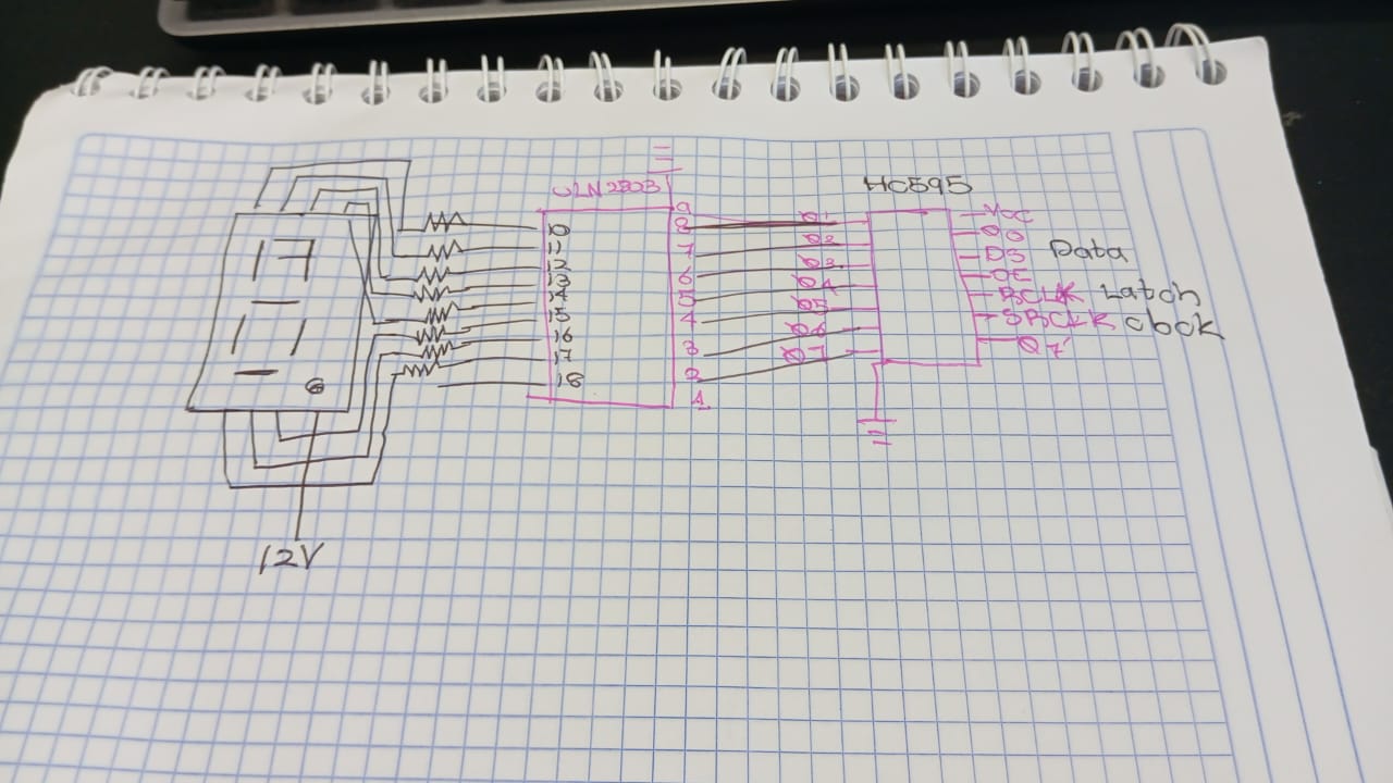

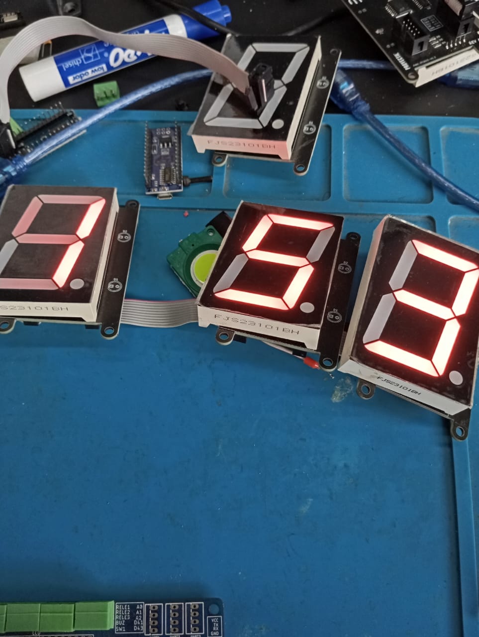

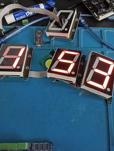

Hello, I need a little help since I have a problem with my project using three shift registers hc595 and three 7-segment displays.
My problem is that I load my board with a counter program from 0 to 999 and the program works, the problem is that when it displays the digits I get small, very faint blinks on my counter and I need them to be gone. Has anyone had a similar problem? I attach my code and photo of the displays.

 ![WhatsApp Image 2024-05-24 at 2.40.38 PM](https://europe1.discourse-cdn.com/arduino/original/4X/2/9/f/29fbd68ad85833763dc7fe145eda3c7083860599.jpeg)
im kind of new so i apologize for any mistake.

Show your schematic.
How the resistors are connect to 7seg?

![Sin título](https://europe1.discourse-cdn.com/arduino/original/4X/7/2/9/72908d461dd005b9e111619fe6dd32e057a093de.jpeg)
Thank you very much for taking the time to respond. Here is my diagram, it is not exactly which pin goes with which pin but it is the idea. I am controlling the hc595 with an atmega328pb that sends the signals to a uln2803 to drive a 7 sec display that is powered at 12v

> [@androide\_neon](#):
> his is the program that im uploading,
There is something vital you have not told us.
What Arduino are you using? It is not a Uno, so without telling us what it is we can't help any more.
As to your schematic:-
Sorry not good enough. As schematic is exactly which pin goes with which pin. Otherwise there is no point. You need pin numbers on every rectangle as well.
It does not even include an Arduino, nether does it show any method of powering and where all the ground connections go.
Basically your problem is down the the fact that your data latch is not actually having any effect. In other words what you think of as a latch is not acting as a latch. That would cause the effect you describe. But you schematic does not give the information we need to be able say if this is the problem and more importantly, what the cure is.
