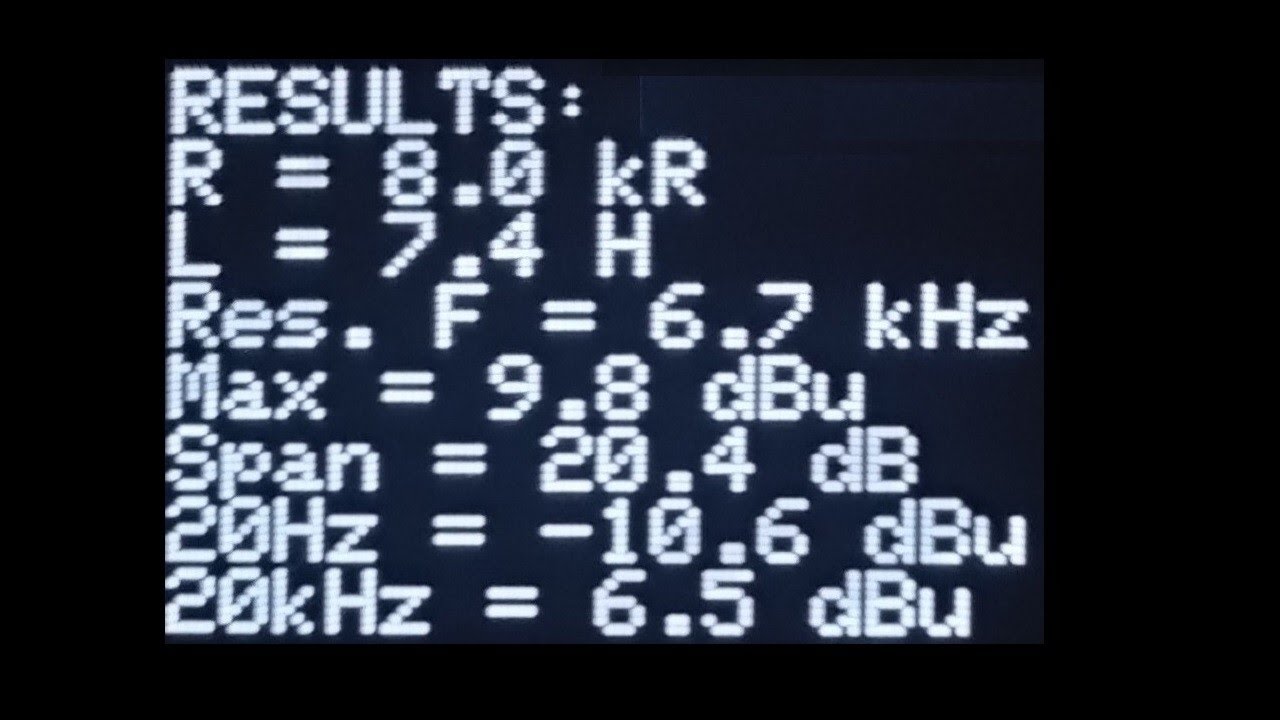

SH110X Problem displaying more than X amount of characters
I have written a program for an Arduino NANO with a 0.9" display using the SSD1306 Library. To improve the readability of the information on the display, I changed to a 1.3" display using the required SH110X library.
Now I have a problem that there is a limitation to the amount of information that I can display. This was not the case with the 0.9" SSD1306 Library.
As an example, if I add one more character to the program, even if it is a space, certain things will no longer be displayed, especially floating point numbers. If I remove this one single character then it all works perfectly.
It is as though there is a smaller display buffer assigned by the SH110X library than by the SSD1306 library.
As soon as I convert the program back to the SSD1306 version and swap the 1.3" display back to the 0.9", this restriction goes away.
It's a total pain because I have had to absolutely minimalise the information I display so that I can achieve all of the required functionality for the program to carry out it's functions and communicate with the user.

There is likely to be a mistake in your code, or you are running out of dynamic memory. For help, post the code using code tags, and state which Arduino you are using (there are half a dozen different Nanos).
Be sure to state the size of the displays you are using, as well.
Thanks for your reply,
If I am running out of dynamic memory, why only with the SH110X library and not with the SSD1306 library?
If there was a mistake in my code then it wouldn't start working just because I removed a single character from a print statement. Everything is identical electrically and code wise, it's only the library related information that changes to convert from the 0.9" to the 1.3".
I cannot release my code as it is the culmination of 10 months work.
If necessary I will write a piece of code just using the display related software to show the problem.
The NANO and display are eBay purchased items. The NANO is described as V3 compatible with ATmega328P.
During startup, the libraries allocate different amounts of dynamic ram for the screen buffer.
Good idea.
If we cannot see code that has the problem and have no idea of which library you are using, then how can the forum help ?
I have used SSD1306 and SH1106 displays, same library, same hardware and have not had a problem swapping between the two displays.
But theoretically, if I can can display more characters with the SSD1306 library than the SH110x library, then the SSD1306 must be allocating more memory for itself.
Is it possible the the SH110x library is simply not allocating enough memory?

The project is shown here so that you have an idea about what is being displayed:
I am re-writing the code to create a dummy version with the same problem.
I should have it finished by the middle of next week.
