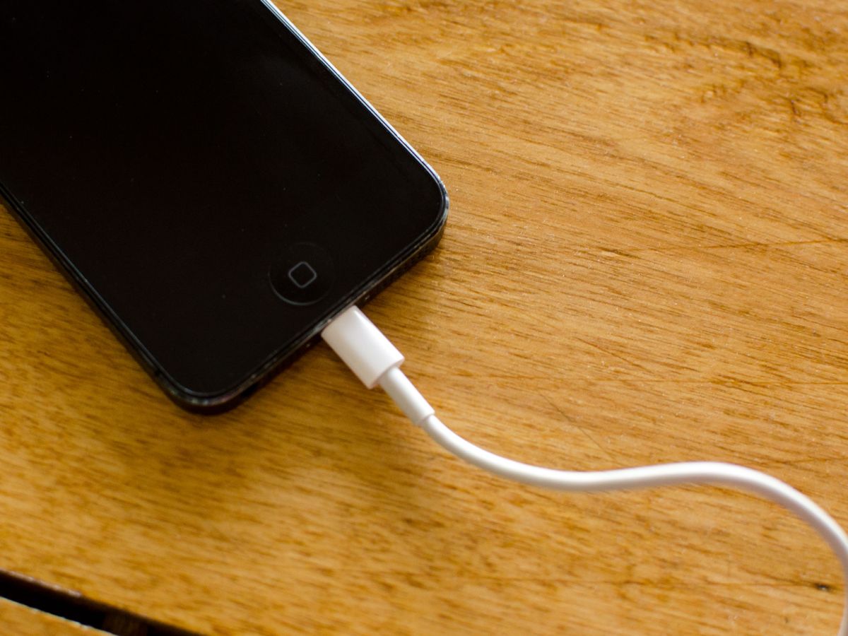

Apparently the charger port of an iPhone is on a separate PCB, and can be replaced "relatively easily" (depending on model, I guess. I was looking at a 5s.) (about the same difficulty as replacing the battery.)
> **[How to fix a broken charge port on an iPhone 5](https://www.imore.com/how-fix-broken-charge-port-iphone-5)**
> If your iPhone 5 isn't charging anymore, here's how to fix it!

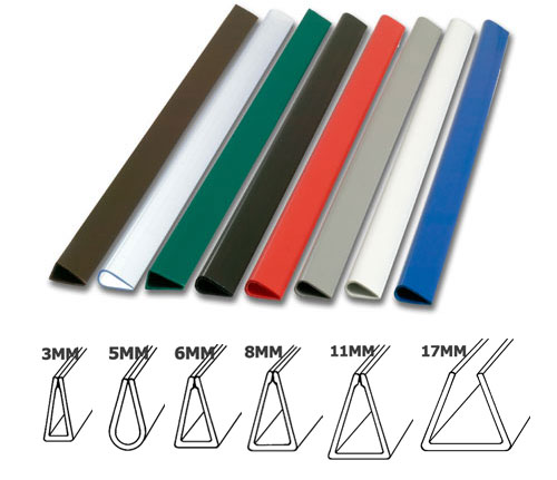

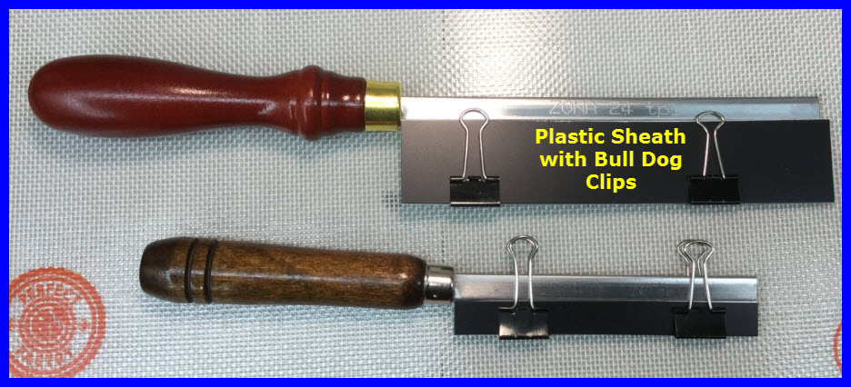

Easier and cheaper, to protect the teeth are these.
Binding strips
Easily cut to length by the saw itself and no clips needed.
Your local stationers probably sell them individually.

Good idea!

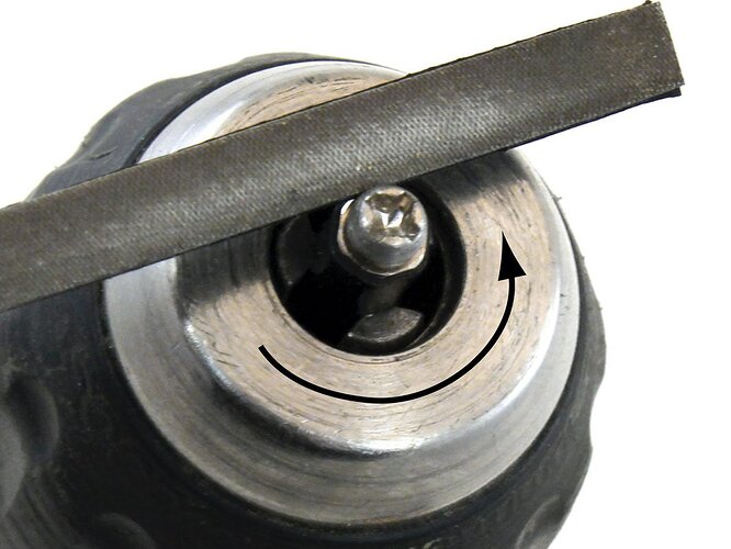

If you have a tight fitting head on the screw, you can cut it down with a file and a electric drill.
 ![C.jpg](https://europe1.discourse-cdn.com/arduino/original/4X/8/c/e/8cef1fe801dff41592a2757708ded74c02e5f94e.jpeg)
To protect the threads, thread the screw into a standoff.

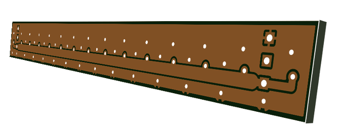

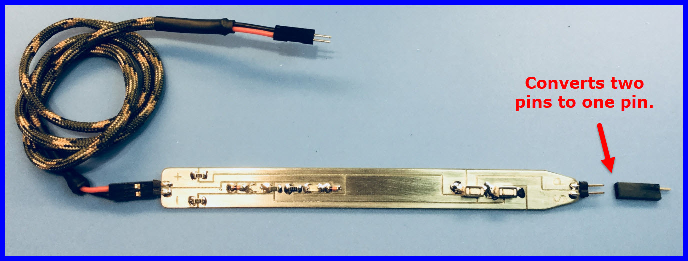

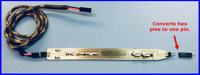

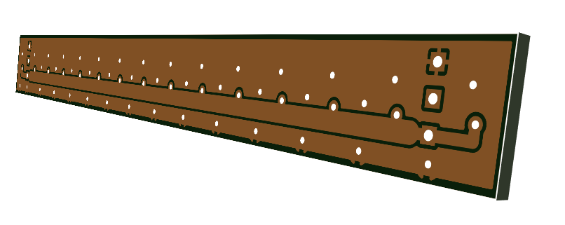

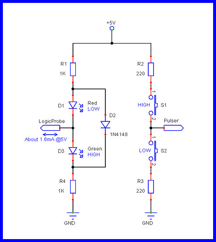

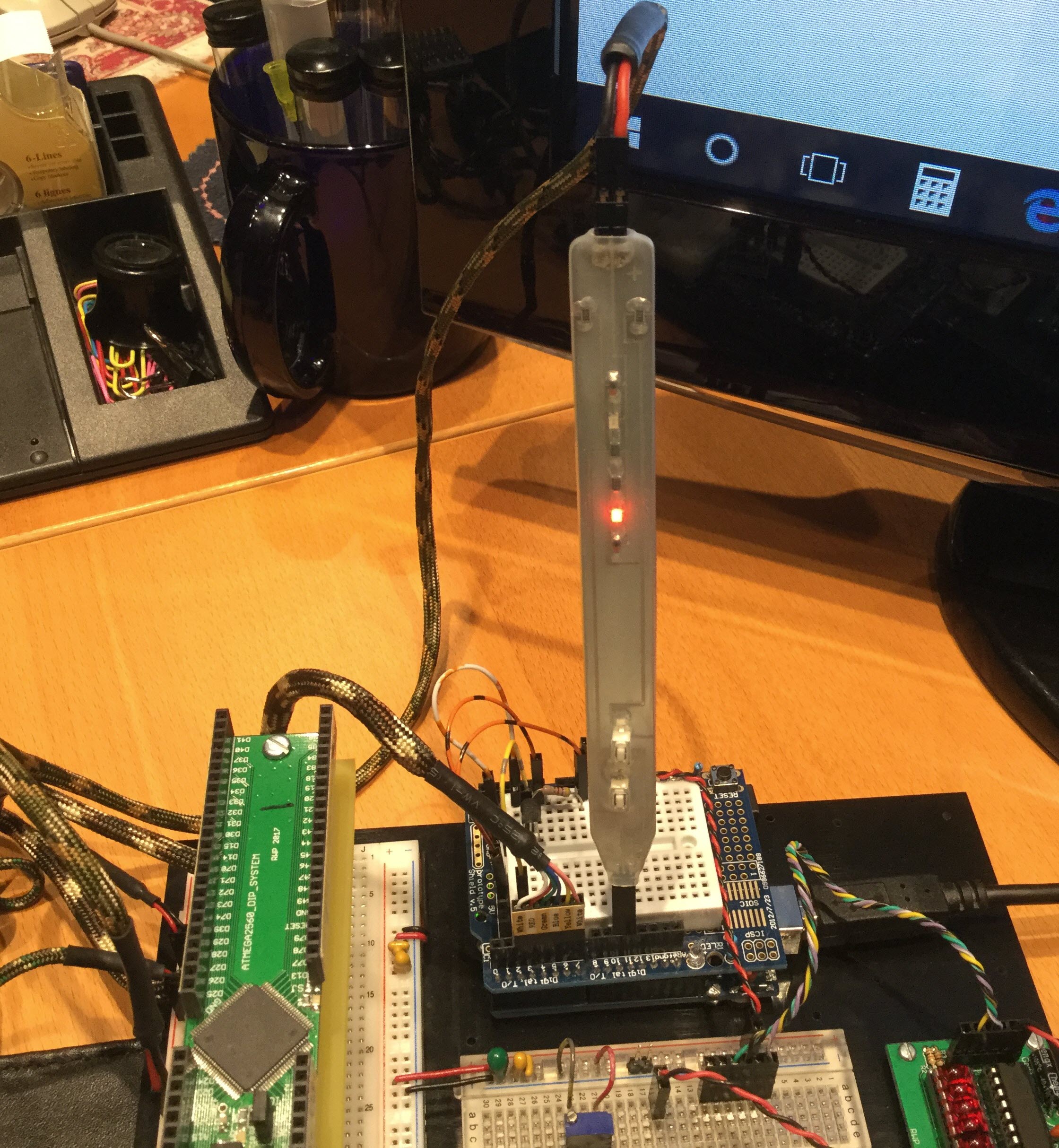

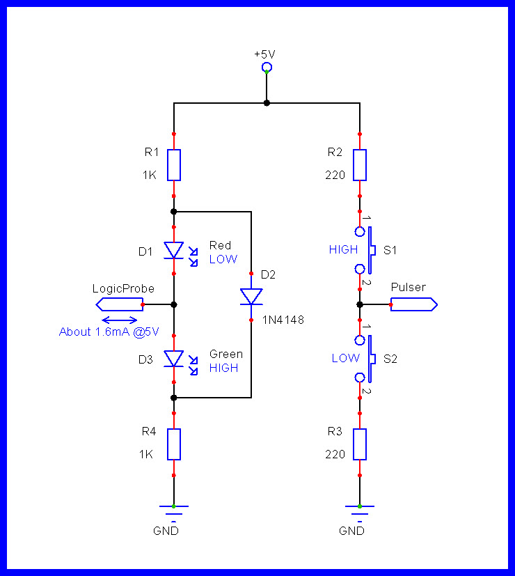

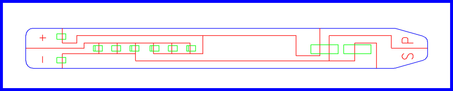

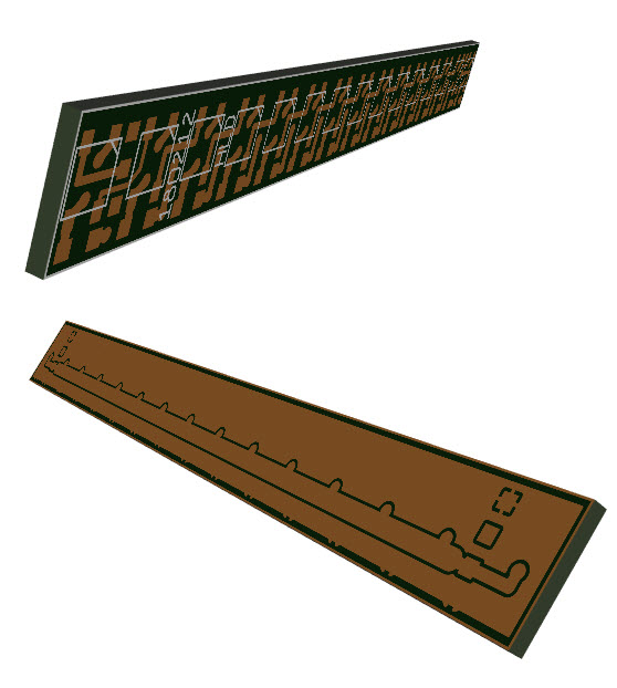

**Make yourself a simple but very useful Logic Probe with Logic Pulser.**
**Resistors, diodes and LEDs are 1206.**
 ![Probe](https://europe1.discourse-cdn.com/arduino/original/4X/d/1/8/d18b30cc55c572e2b287aa84924a5af6047eefe8.jpeg)
 ![2018-01-30_20-51-09.jpg](https://europe1.discourse-cdn.com/arduino/original/4X/6/a/d/6ad44c4c443eb6441c322b03ca94844db9d90fe7.jpeg)
 ![2018-01-30_21-17-36.jpg](https://europe1.discourse-cdn.com/arduino/original/4X/9/9/e/99e55dee2847828cac83bef38dc910f691d2f8cc.jpeg)
 ![2018-01-30_21-18-06.jpg](https://europe1.discourse-cdn.com/arduino/original/4X/b/0/7/b07aafef8caf1698fc4fc501e0f3583663f07462.jpeg)
# EDIT
- **D2 has now been added.**

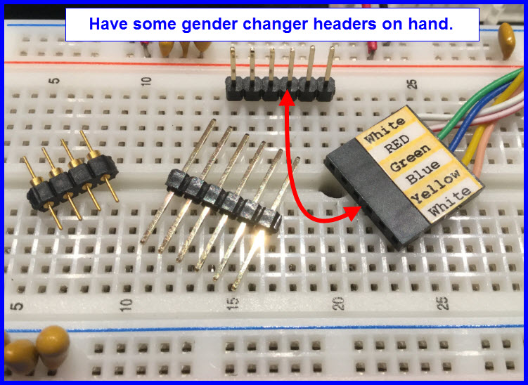

I find there are many times when I need to access an Arduino header pin with several external devices.
You can make a simple interface with male and female headers.
Cut a 6X1 male header and two 6X1 female headers.
Solder them as shown in the images below.
If you have a long pin (stackable) female header, you 'don't need the male' header. 😕

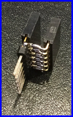

Got to get my inventory under control. 😕
I did have some stackable female headers.
These turned out much better.

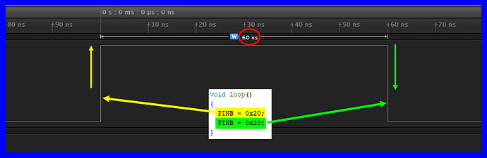

If you have access to a Logic Analyzer or a Storage Oscilloscope, you can use them to time events when troubleshooting your code.
A write to pin D13 on the Arduino using the PINB command, toggles that pin’s state.
Toggle: if the pin was ON it goes OFF, if it was OFF it goes ON.
examples:
PINB = 0x20 // Toggle D13 ATMEGA 328
PINB = 0x80 // Toggle D13 ATMEGA 1284 or the ATMEGA 2560
Having two of these commands in a row gives a pulse of ~62.5ns (nano seconds) for 16Mhz clocks.
Creating a pulse on D13 can be used to mark the being of some code.
Adding a second pulse on D13 at the end of that code times how long that code took to execute.
- The first image shows the timing relationship between the two PINB = 0x20; instructions, ~60ns.
- The second image shows how long it takes to go from the end of loop() back to the beginning ~1.13us and it shows the time it takes to go between the two pulses ~100us.
 ![1.jpg](https://europe1.discourse-cdn.com/arduino/original/4X/a/7/5/a7554853606c22aba8e9268076d6142f4aa377fb.jpeg)
 ![3.jpg](https://europe1.discourse-cdn.com/arduino/original/4X/e/b/2/eb2238eaba2ee760f2a2b38d821b83038ead2df2.jpeg)
See also post #968

EDIT
This site needs you to drag your non zipped file(s) onto the web page.
You then re-assign your files to equivalent surface names.
You can then orbit the 3D PCB rendering using your mouse.
[webGerber](http://mayhewlabs.com/webGerber/) **\<----\<\<\<\<**
> **[3D Gerber Viewer | Mayhew Labs](https://mayhewlabs.com/3dpcb)**
> With this viewer you can upload your Gerber files and have a 360 degree view of your PCB design. Launch the viewer to load your own design or view one of the example boards. You can get … Continue reading →
