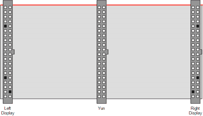

The only part of the design that might be unique is the use of a 40 pin (2 rows x 20 column) header for the display connection. The displays have single row 18 pin headers. By using a ribbon cable with three connectors crimped onto it, the shield can be connected to both displays, while still allowing independent control. One display is plugged into the odd row of pins on one connector, the other display is plugged into the even row of pins of another connector, and the last connector is plugged into the dual row header on the shield. Most of the pins are connected in parallel between the two displays: the exceptions are the individual display enable lines, and the RGB backlight LED control lines. The cable will look something like this:
![|500x285](http://www.ssav.org/arduino/DualRgbDisp/DualRgbLcdDisplay - Display Cable.png)
Note that the cable length is not to scale, I intend to make it longer than is implied by that drawing (probably around a foot total length, definitely less than two feet total.) The dark pin spaces are keying inserts - plugs to prevent the cable from being plugged into the displays incorrectly. It’s a bit of a waste using a 40 pin cable, when 36 pins are all that are needed, but while 36 pin connectors are available, they are significantly more expensive than the more standard 40 pin versions, and I already have a sufficient stock of 40 pin connectors in my parts bin.
