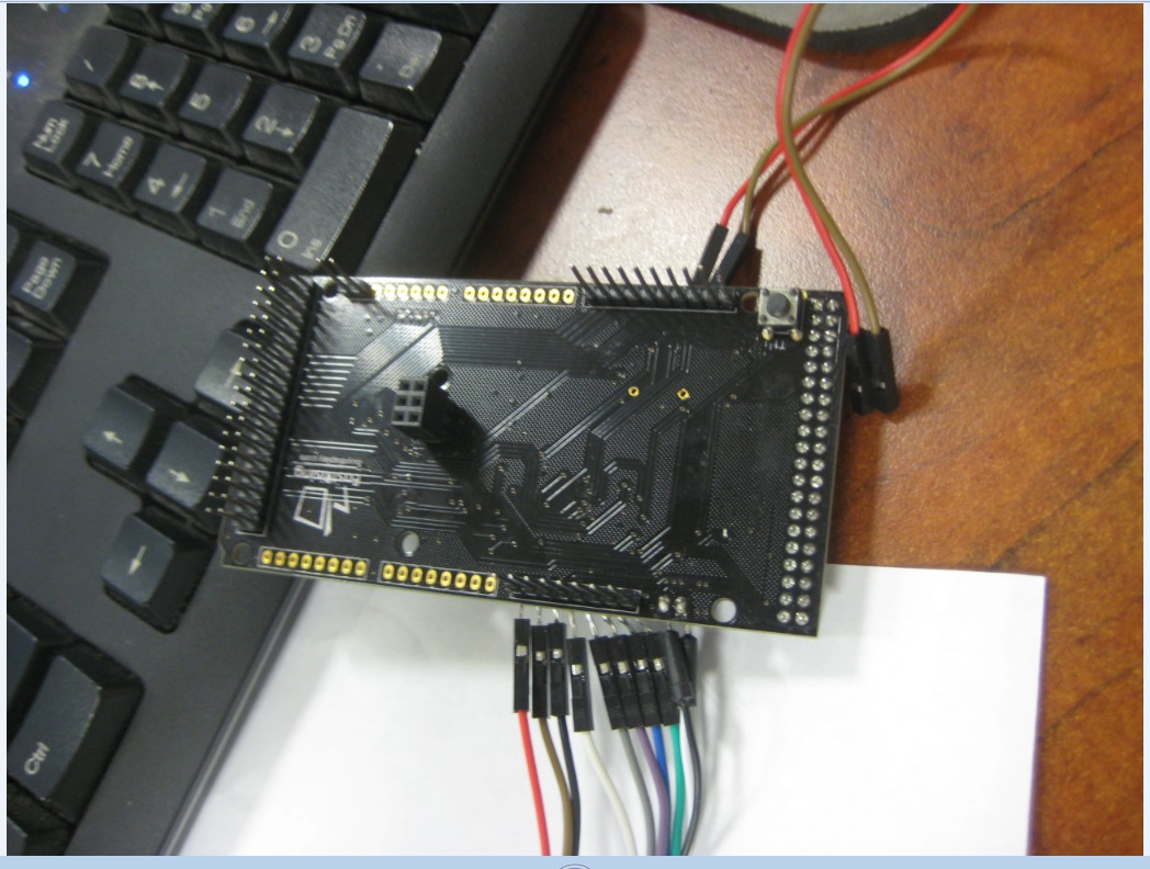

So I bought the Buy Display 7" TFT resistive touchscreen.
It was working great. The library and examples that came on the page work. (unlike I never got the sainsmart working).

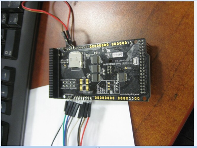

then I decided to solder some male to female pin connectors to the pins that are covered by the shield. Now when I plug in the arduino, nothing happens. screen don’t turn on, no green light from arduino board. But when I remove everything from the arduino board, I can upload “blink example” and it works fine.
Did I short something out with the wires I solder on?
Sounds like it.
anybody can look at the picture and guess which pins are probably the problem?
Whats at the other end of all those wires ?
The pics are not good enough to actually diagnose a bad solder issue etc.
You have it in front of you so are clearly the best person to do that check.

If it's preventing the power light on the arduino board from coming on, that implies that you've shorted 5v or 3.3v to ground...
Thanks for the input!
I tested on the the display shield. Where it is plug in to Vin and GND on the arduino board has short.
and IOREF also have short with GND.
But nothing looks wrong on the board. Did I melted the conductors internally of the board from the heat of the soldering?
nosajnil:
I'll bet solder flowed down through the holes and bridged those pins between the plastic part of the connector and the PCB - you would have had it with the plastic facing down, and were putting a big blob of solder on top....
Is this still fixable? (remove the plastic connector and redo everything) .
or something already got shorted and burned the board?
